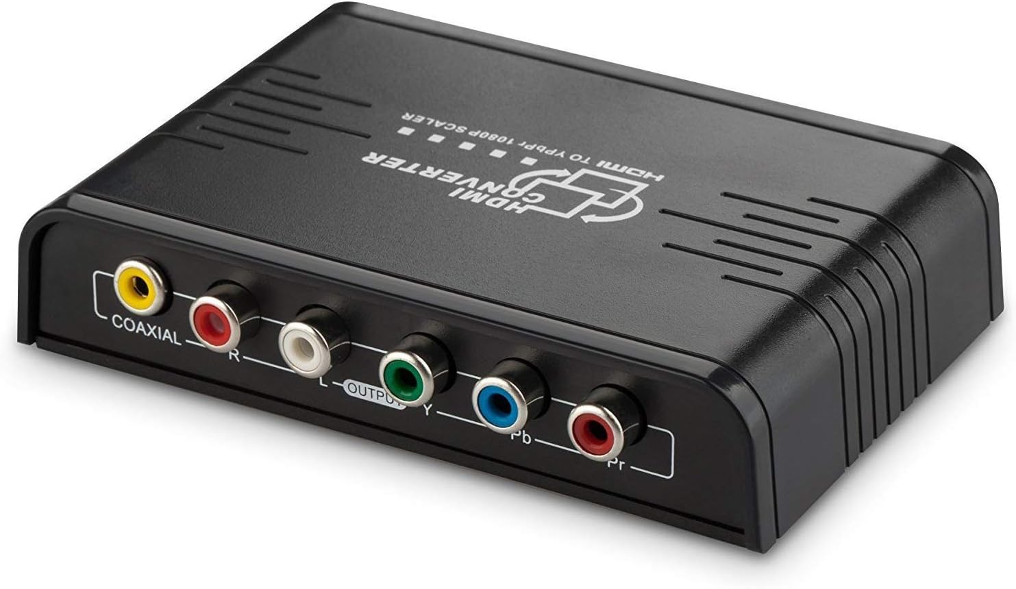

I have this one, and it definitely works. Probably worth the extra $20 to be sure you don’t get a turkey. Apparently, there are some similar-looking things on Amazon which are terrible..
https://www.amazon.com/Universal-Premium-Quality-Component-Converter/dp/B017LVMAWG/
I bought this HDMI -> YPbPr converter and it works great
Musou HDMI to 1080P Component… https://www.amazon.com/dp/B01F6URXYY?ref=ppx_pop_mob_ap_share
