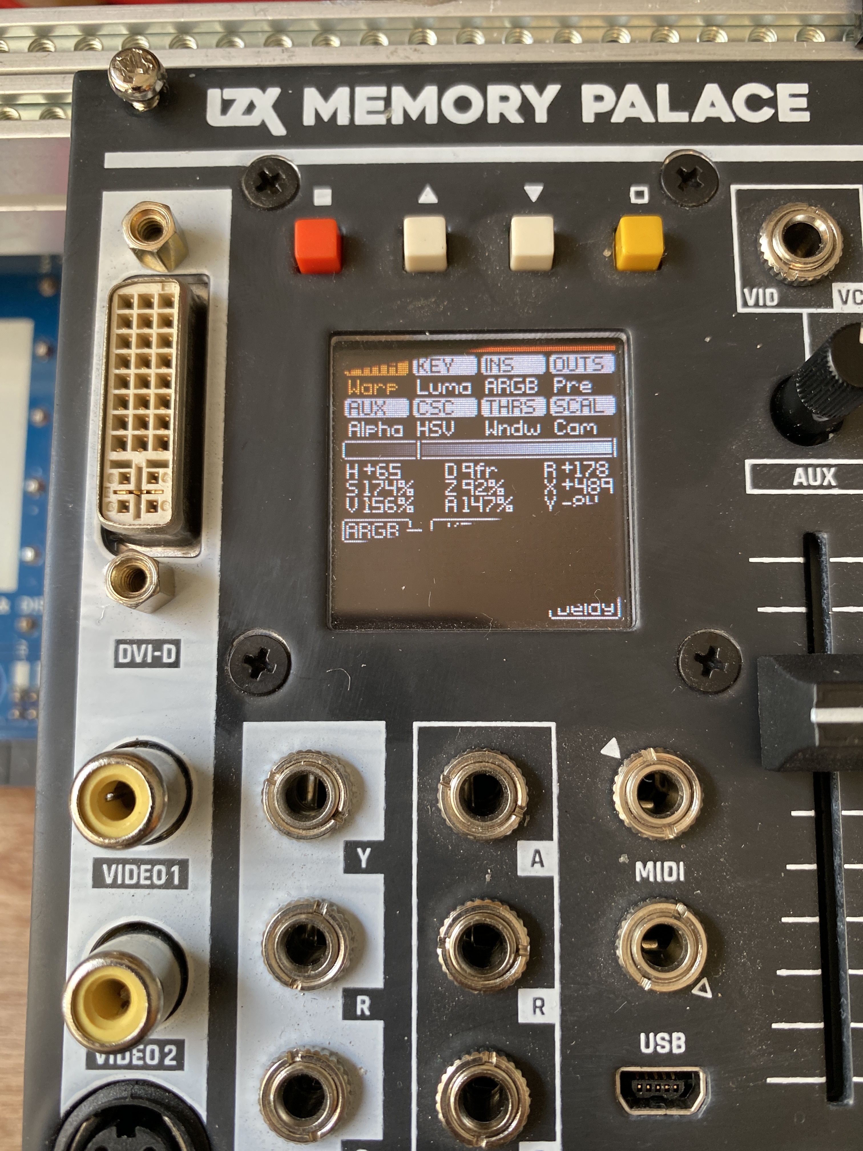

Could you include a photo of the weird icons you are seeing?

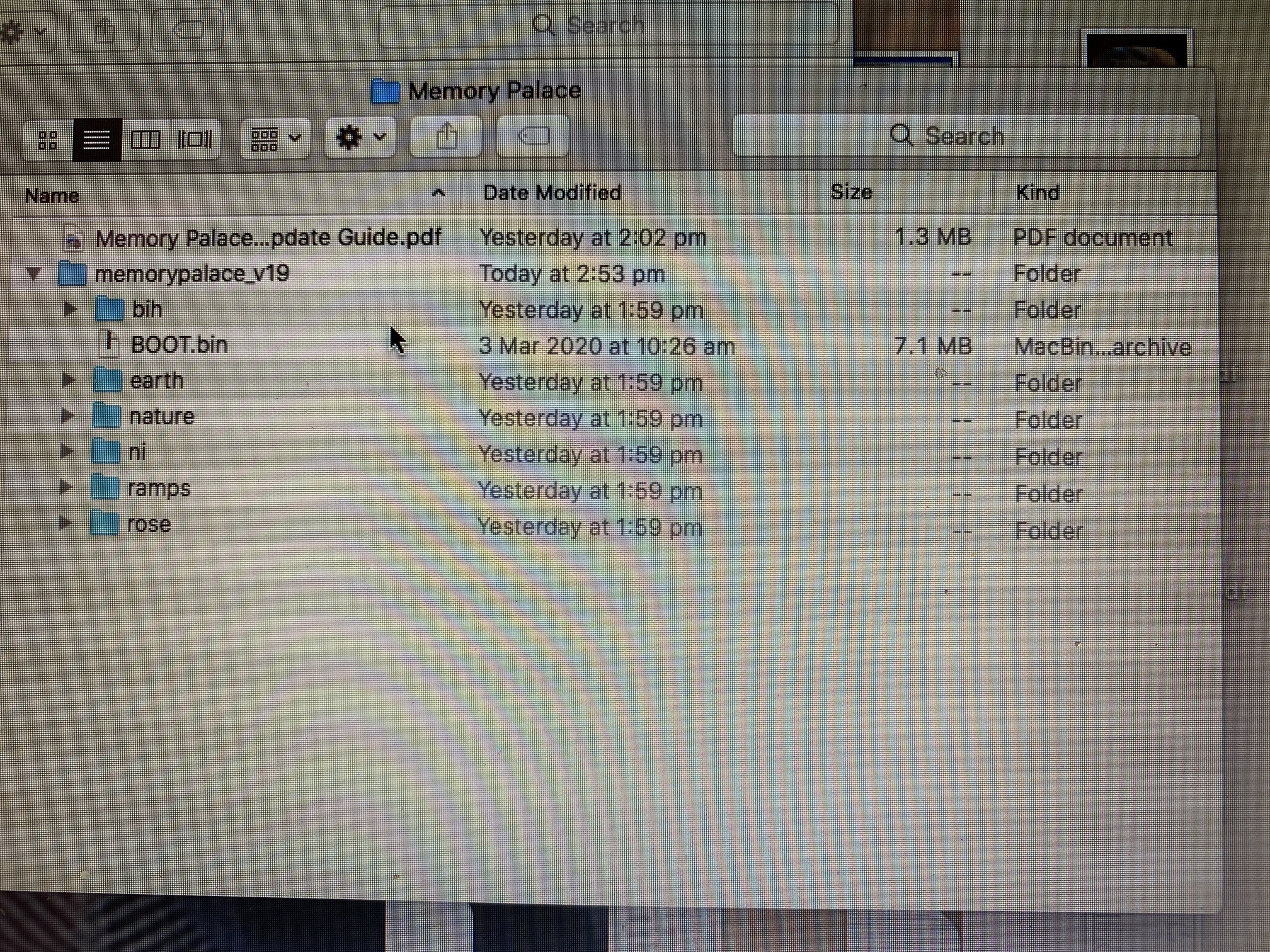

Ive reloaded the Sd card from the downloaded file. Is it supposed to look like this?
The funny characters dont appeat anymore but when I upload new firmware in the menu it stalls then shuts down for about 3minutes. The fan and lights on the back are still on though.
