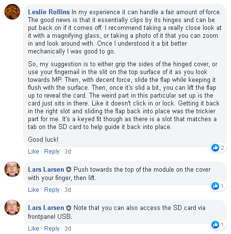

Here’s a link to a thread on the FB group page which may be of use to you:
Thanks.
Leslies tip with the fingernail on the metal casing did the trick.
The problem previously was that I was pushing on the actual card… the card doesnt move at all hense the concern something might break.
The metal outer casing moves quite easily however.
