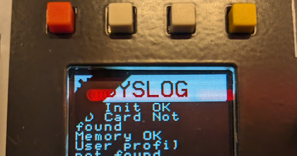

1st problem:
  • SD card is not found
    tried to format it and use some others, but without success
  • tried to enter via usb-port, which gives me access to the device folders /jsn with media.jsn & system.jsn
  • tried to install a recent firmware but the device crashes at boot time
  • also cleaned the SD slot :[

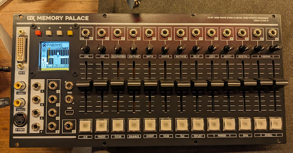

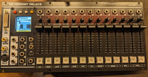

2nd problem
the faders seem to be out of calibration and wiggle by themselves slightly
  • is there any way to recalibrate them? :B

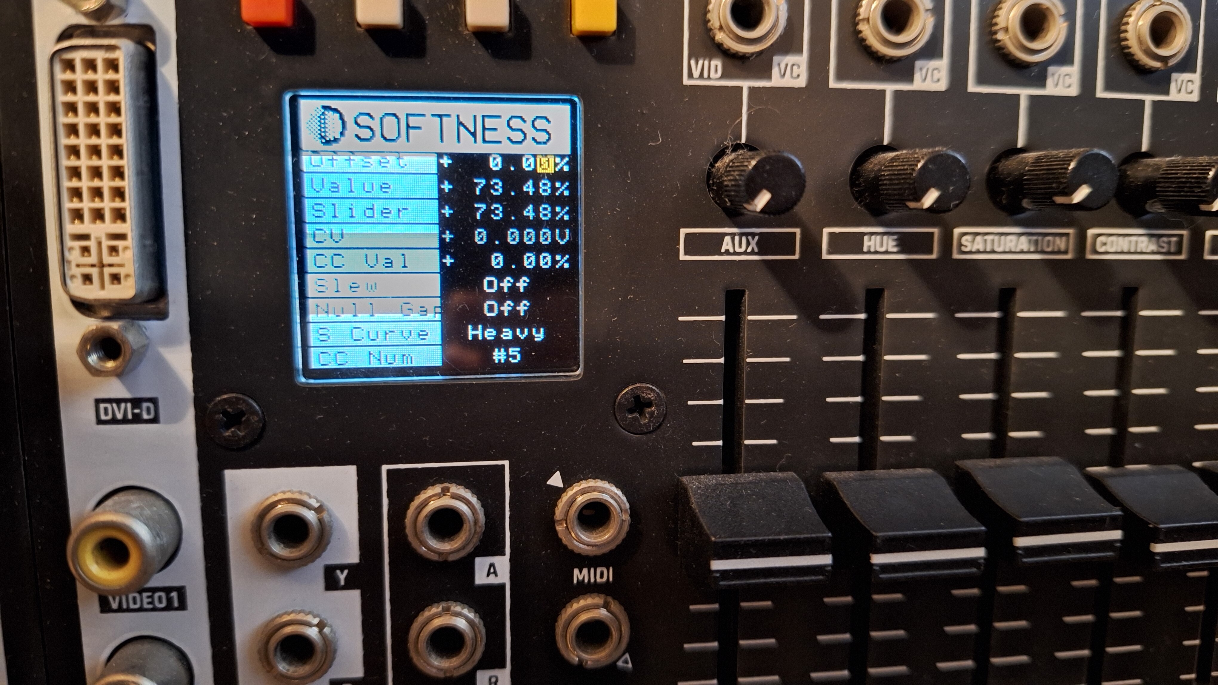

My unit has that same slider behavior when loading default settings. It appears that the SOFTNESS slider has S Curve setting on Heavy that causes it to sit at 73.48%. Changing the S Curve to Off puts it at 50% (centered)

In that case, it sounds like a broken SD card slot.
