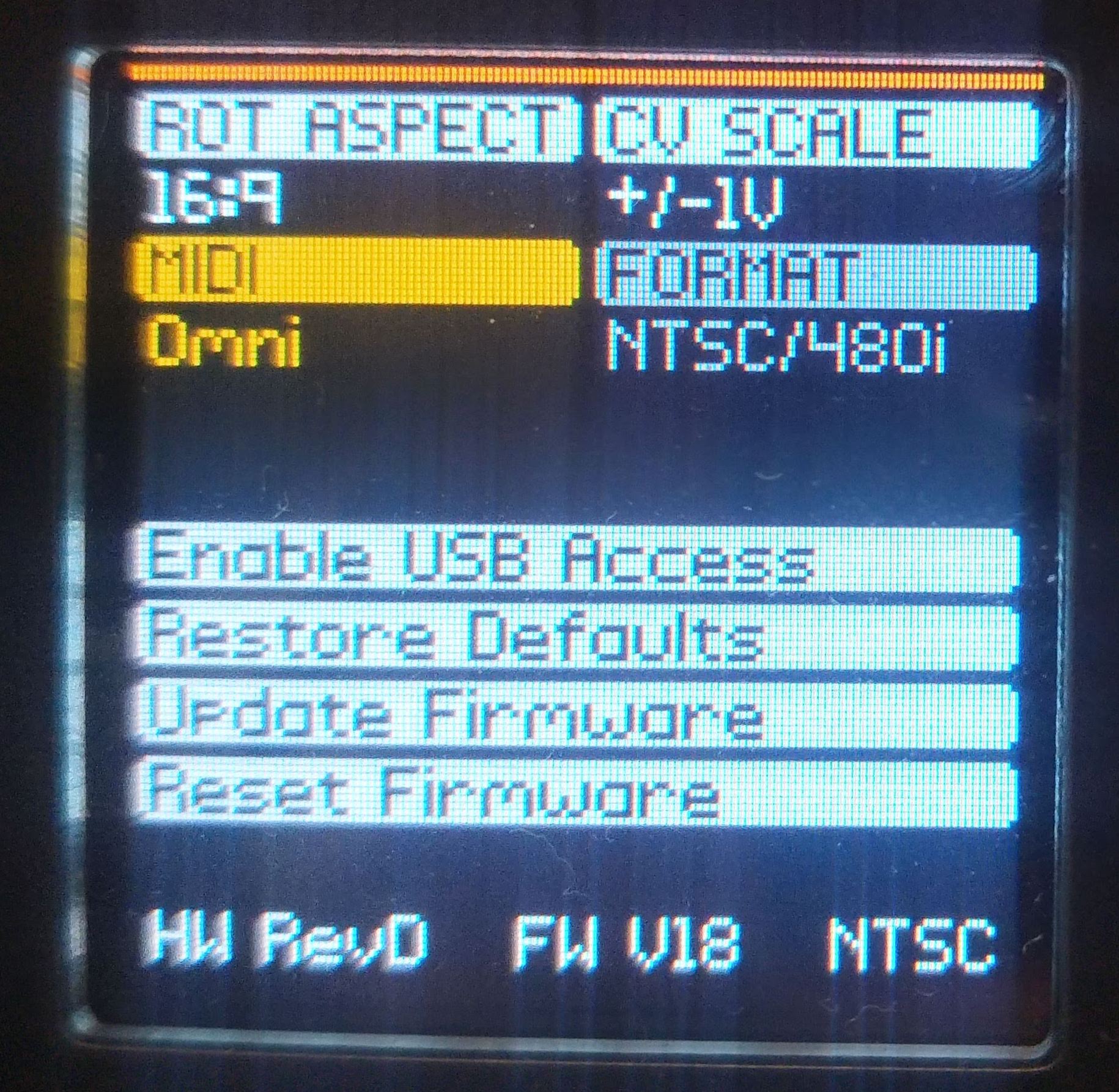

Im unable to change the NTSC/PAL mode when using my Memory Palace as master.
When it boots, its by default in NTSC and the menu to change that is disabled, is there a special button combination to change the value to PAL? I have rev18.

@luix It sounds like you have Memory Palace in external sync mode. You can only select the NTSC/PAL format in internal sync mode. In external sync mode, Memory Palace will detect the sync format from the external source (patched to sync input on the rear.)

Exactly, what Im saying is that when I put the sync switch on INTERNAL, I cannot select PAL on the menu its still disabled (grey) regarless of the switch. I’ll wait for the v19 and see if that fixes the problem.
The auto detection (when external is activated) is not working well, and neither the switch internal/external. I want to be able to select PAL/NTSC manual anyway always if is possible.
@luix What is your sync source that it’s having trouble detecting as NTSC or PAL? Is this with Visual Cortex? We had one report so far where the switch was actually broken, does it look damaged at all?
My sync source is Visual Cortex with decode switch off (to use internal sync of VC). MY VC boots nicely every single time in PAL, Im syncing it using the SyncOut of VC into the SyncIn of the MP with the terminate ON.
Switch and soldering looks good. I’ll just wait for v19 and see what happens, thanks Lars.

I have the same problem, can’t switch from NTSC to PAL in internal sync mode. Format is greyed out/disabled and can’t be selected.
