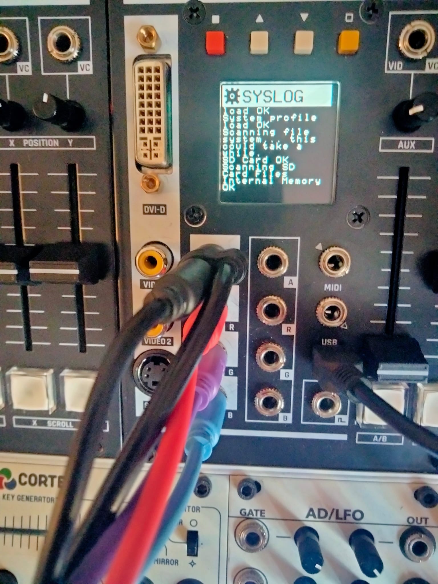

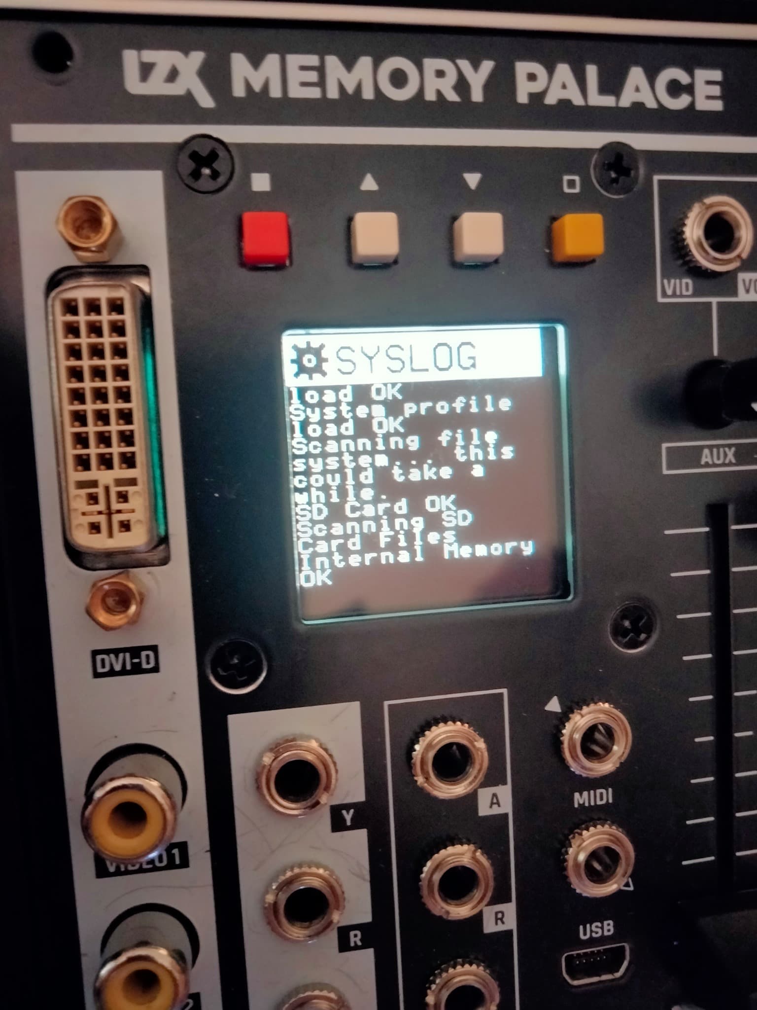

This is the problem, i have 24 folder and no one is up to 64 images or with 2mb filesize
and on power-on it stuck here
i can provide the folders if ithey serve to replicate the bug
I don’t believe it has anything to do with the files. What is your sync source and routing?
visual cortex —> memory palace (in photo) ----> second memory palace
I tried even with no external sync but same error
I delete one folder and then it work…
Aha. If it works when you delete one folder, then you should proceed with that method until the next firmware is available. Do both Memory Palaces behave identically if you load them with the same media?
Yes they acting identical, thanx i ll wait the next firmware!

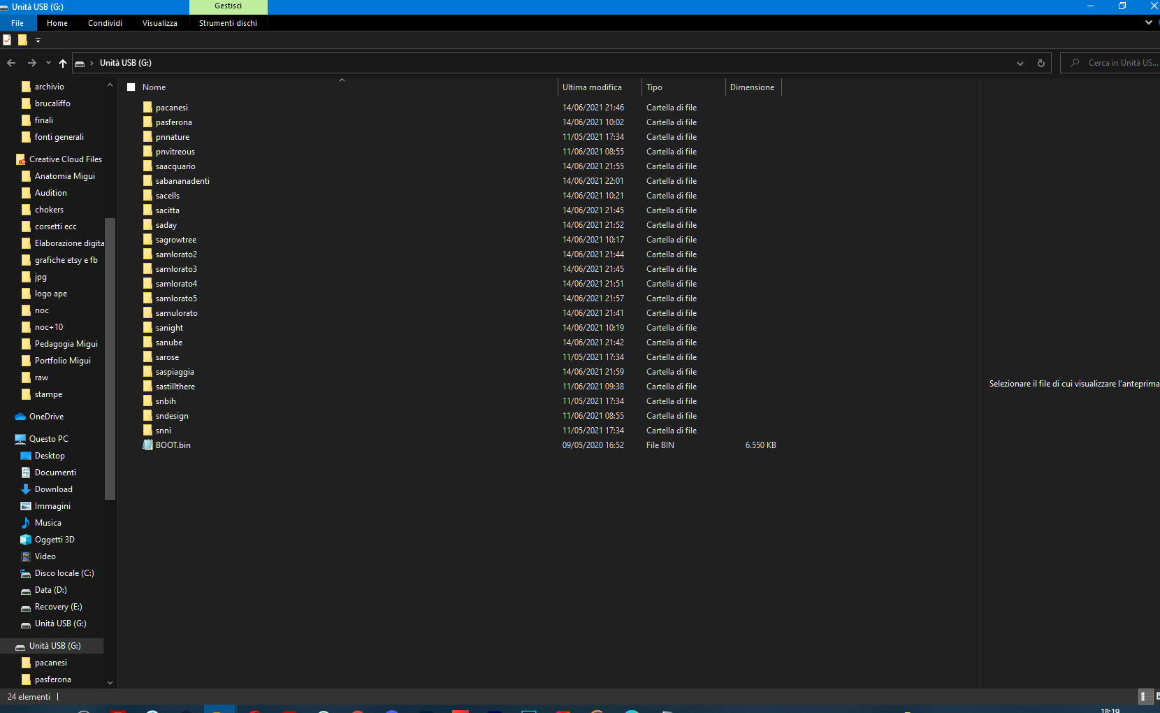

Ok, why my memory can’t start with this set…
https://drive.google.com/drive/folders/1qReT_0Y7tWXVu9q8iYUVyF7Kc4TNelR3?usp=sharing
I can’t figure out
Maybe it’s a sync issue. My MP usually gets stuck on that screen when there is an issue in the sync chain. If your MP is at the end of the sync chain, then maybe check to see if the termination button is engaged.
Found the problem!
In V2.0.1 there is a limit to 1024 files.
