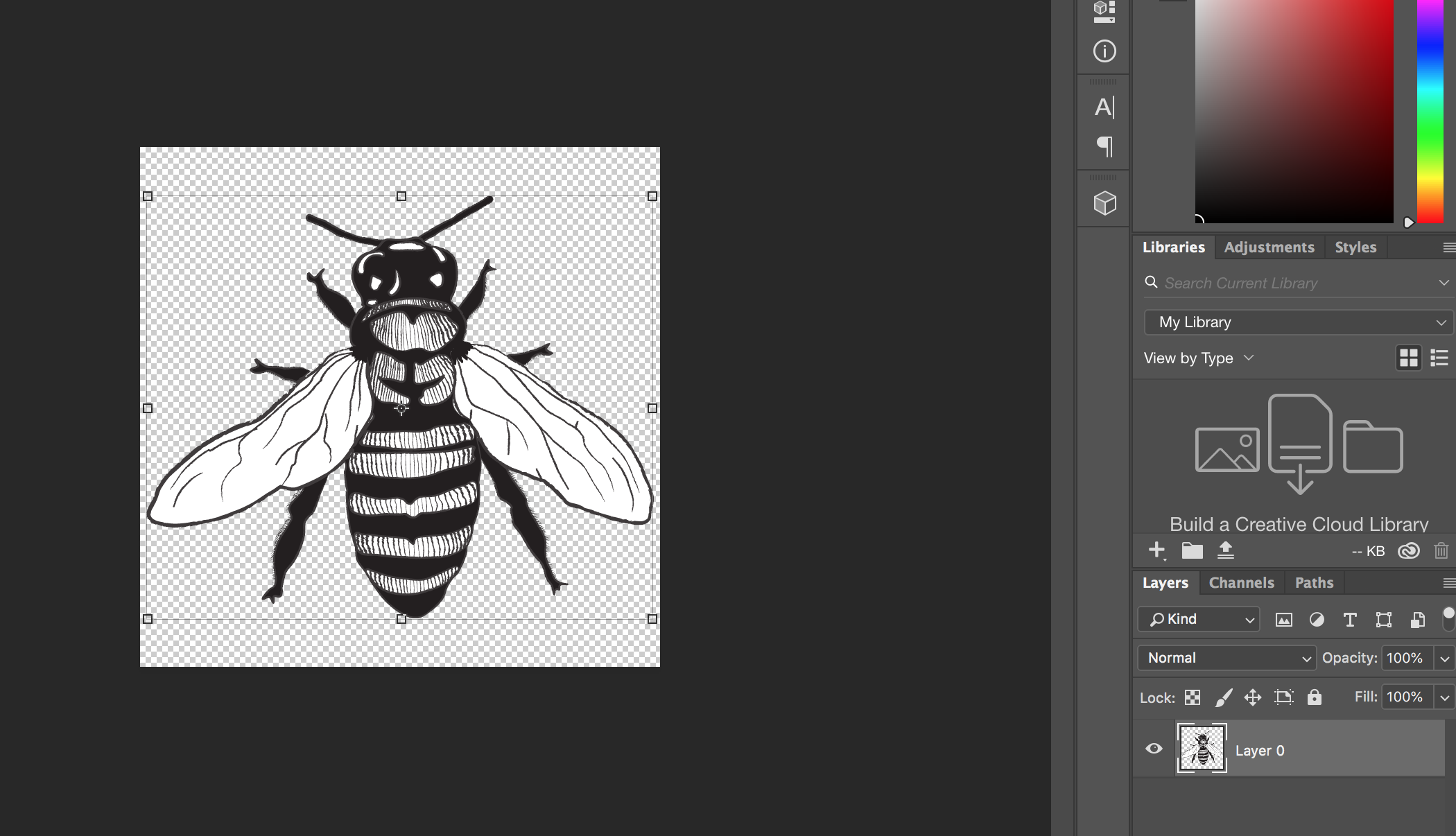

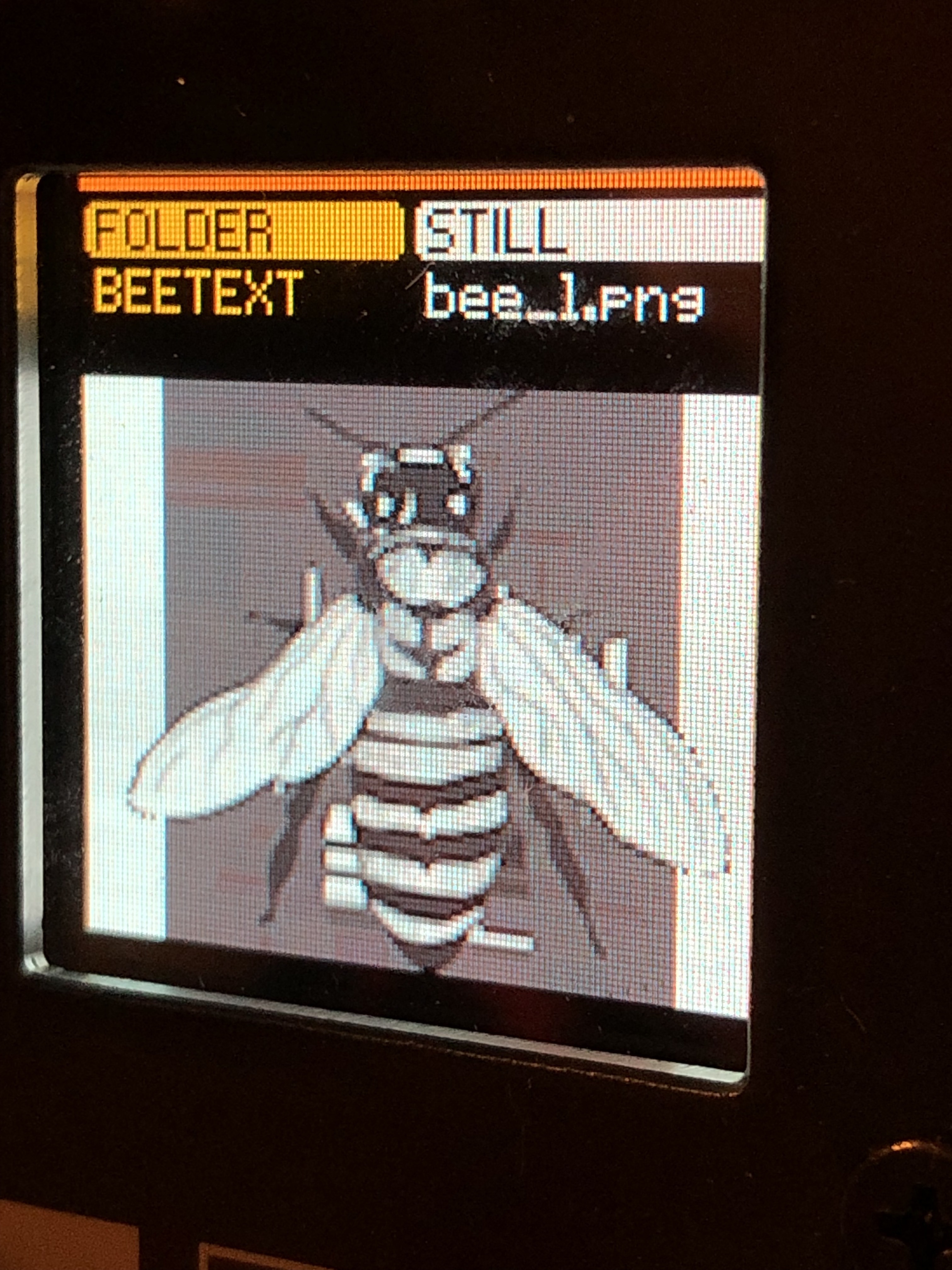

I’m trying to export some stills for MP processing. My goal with the bee image is to get it into MP as it appears in Photoshop with no background layer, not unlike the bee image that’s included in the nature folder of the pack-in MP stills, even though that’s a JPG. In Photoshop, I only have this one layer, as you can see on the right, which appears to contain the bee and nothing else. However, when I load it into my MP, it appears on my TV mostly as it appears on the MP’s display when the sliders are at 0 (notice the reddish artifacts in the bg and the white artifacts near the bottom). I have also tried to export as a JPG which gives me slightly better results when keying, but the width and/or center sliders have to stay below the middle, or else the background will reappear if the sliders are in any position above 50%. Any PNG/JPG optimization tips so that I can utilize the full range of the sliders?

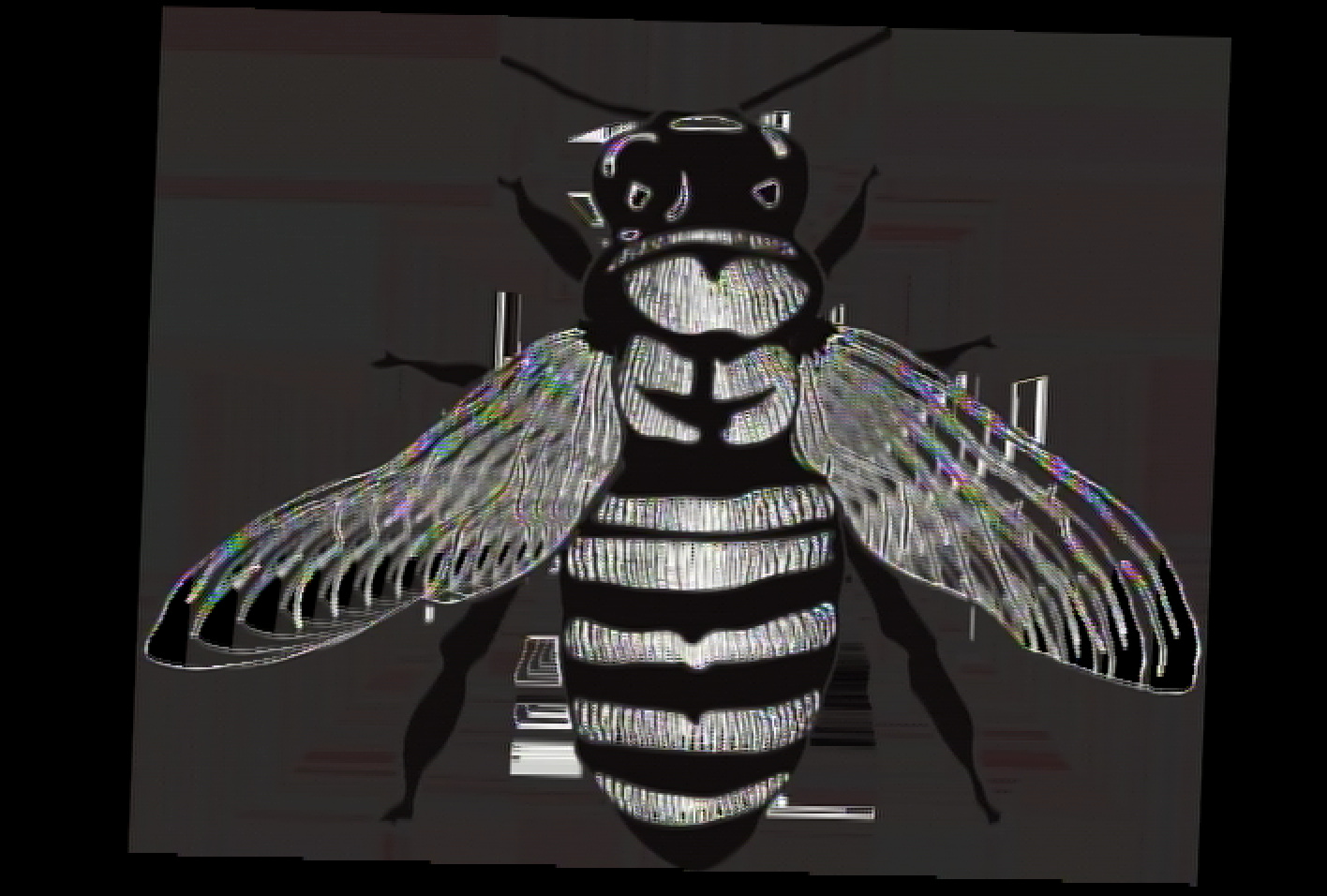

Edit: Here’s a still of what actually displays on my TV, still a little different from either of the other iterations. The crooked frame is just due to me not quite being zeroed out.
Edit 2: It appears if I set the KEY mode to Alpha, the center and width sliders active regions swap to the top 50%.
