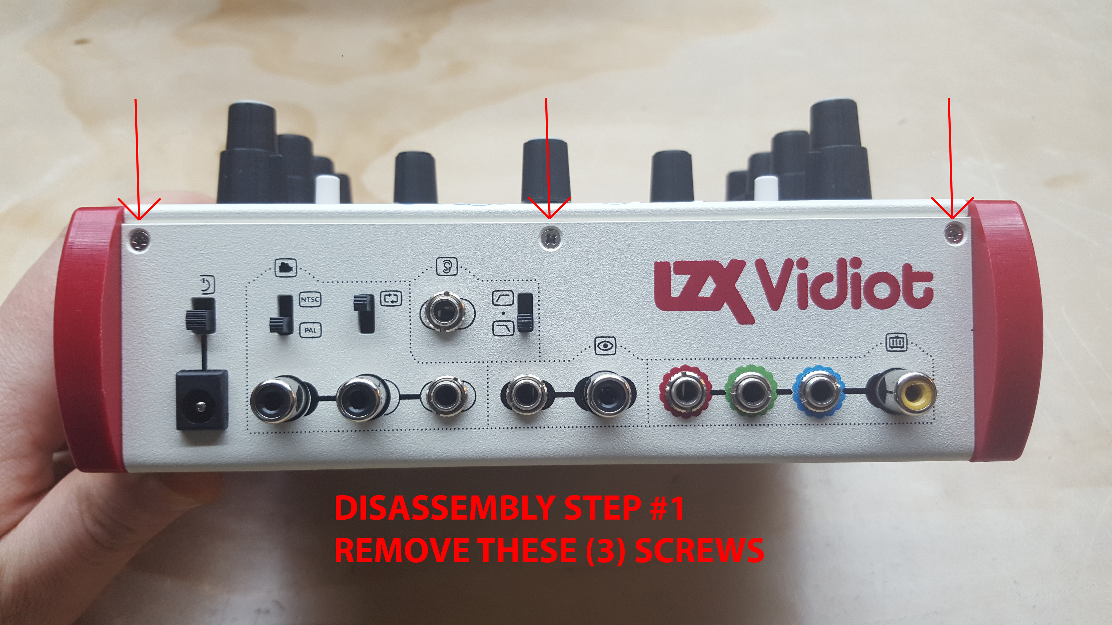

Step #1. Remove (3) Philips Head #2-56 screws.

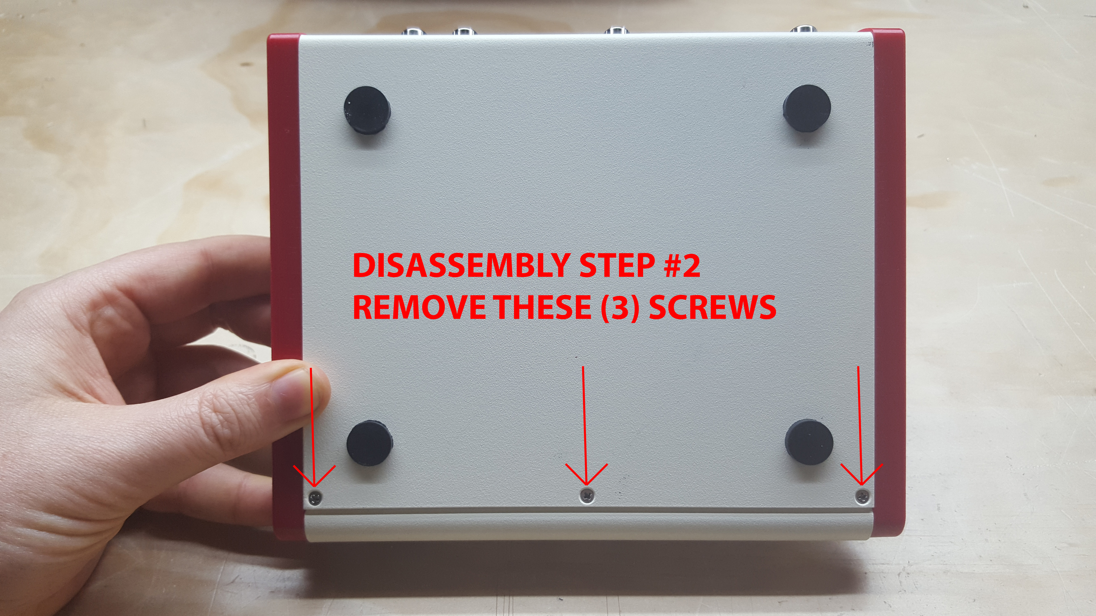

Step #2. Remove (3) Philips Head #2-56 screws.

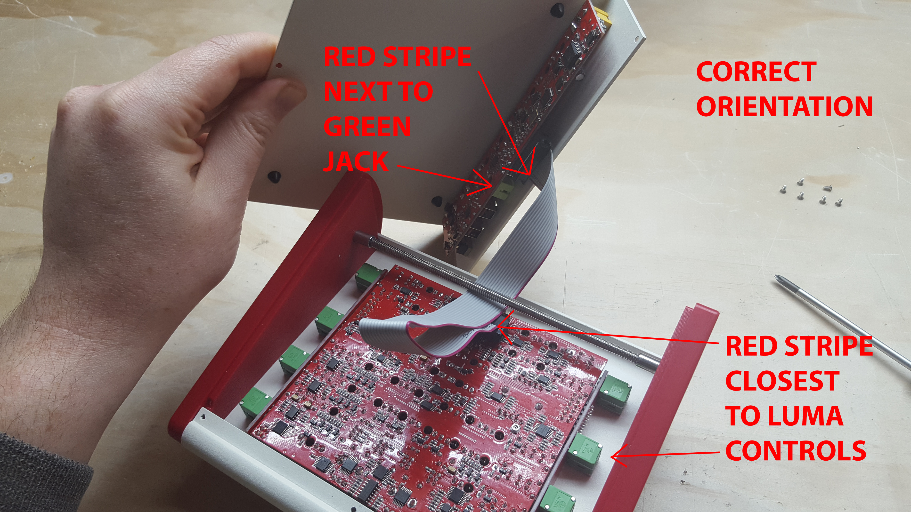

Step #3. Separate the rear enclosure piece gently, then unplug and reinstall ribbon cable exactly as shown below. Make sure cable is firmly seated on both ends.
