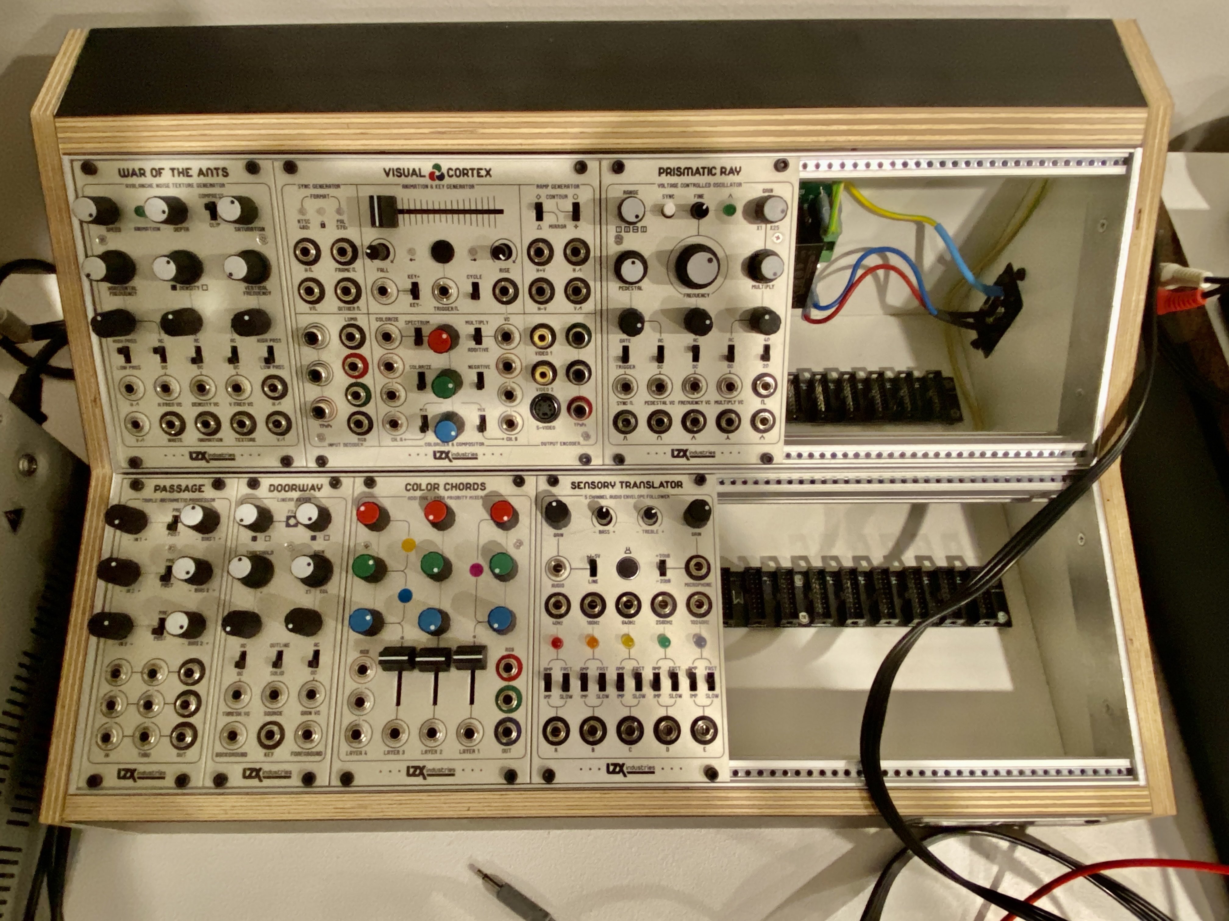

I recently acquired this setup and have just started my video endeavors with LZX. Any thoughts on with where I am at right now?

Would Staircase be an essential addition?
staircase is a great module - so if you can find one then go for it
but all the functionality of the expedition series will be available again - in the new line, eventually so I wouldn’t worry too much if you can’t find it
synotonie.fr do a quad frequency doubler that is vaguely similar to 1/2 of staircase - but no modulation inputs or phase
do you have any other eurorack gear - you could do with some modulation (and attenuation for that modulation) and possibly waveshapers
Second the call for modulation- really surprises me how few people have LFOs in their racks

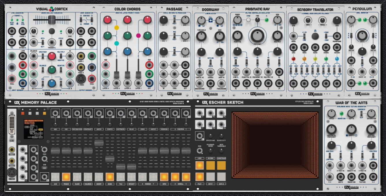

If you have 208HP total, you might consider something like this. You could sub Staircase for Pendulum, of course.

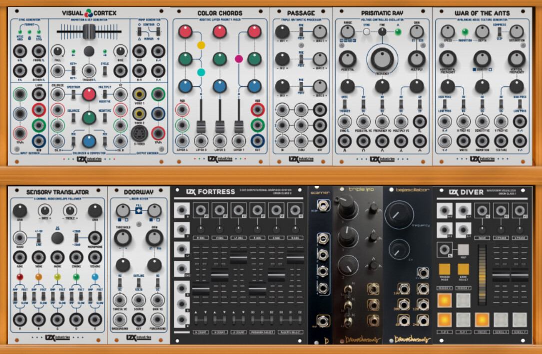

I would totally recommend Diver.
Together with sensory translator and Memory Palace is a killer combo.
Thanks for all the responses! Right now everything is housed in a 6U 84/114 HP powered case with Doepfer PSU-3 power supply, so I have a bit of extra space. I own no other Eurorack gear, but I do have this chained with an Edirol V-4 and some circuit-bent processors. Seems like I am lacking modulation
at the moment.
