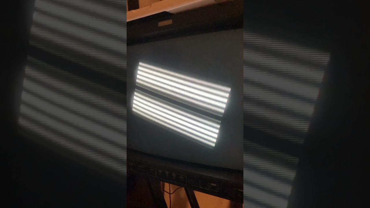

Hi, I’ve recently acquired a second-hand Memory Palace and am experiencing an intermitent issue where an image from the SD or external source will briefly glitch to a different location.
I’ve tried reinstalling the firmware, removed all external connection and set to internal sync but the issue persists.
I’d like to know if there’s any troubleshooting I should try for an easy fix or if I should return it immediately.
Here’s a quick video showing the problem:
That glitch was really common with V19. Which firmware are you using? Also, what is your sync setup?
I really should have read the thread I was commenting on, where all the symptoms were already addressed :slight_smile:
I was on 19 and updated to the 2.0.1 beta this weekend and it feels like a brand new machine, the glitches are gone, the menus are way more responsive, folders load faster… There’s still a bit of jitter on images but it’s really night and day to what it was.
