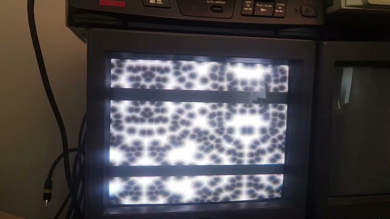

Next problem with v2.0.1 :
Can anybody tell my the media loader ramps are all 16:9?
Aspect ratio is set to 4:3. Format Pal
The black bars are better visible with tile & reflect
(and the stuff which is tile & reflect is really jittery.. but maybe thats also a betaversion problem)
Nobody had this problem?
I think I just got used to the black bars. I actually use them a lot as a compositional element. It helps breaking apart some patterns.

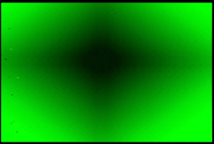

I’m getting noise or small pixels from the video outputs of my mp on the left side of the screen .It seems to have pattern.
Is that a defect or a feature?
That’s from the CVBS outputs? Have your tried the DVI-D?
Nope,would be a bit difficult to set up atm,but i’m getting it on the rgb outs and the rca jacks.I’m routing the rgb signal into a structure module,which feeds into my tv and a shuttle express.
I’ve recorded a couple of clips today.The noise is barely visible in one of them and not at all in two others.Still want to get rid of it if possible.
Do you see the noise only when running through Structure, or is it visible when monitoring from the TV and shuttle?
No,i also took video directly from memory palace and it’s still there.I see it on the tv and imac,where i record video.Looks like it’s definitely mp.Never had it before with structure,vidiot and my other lzx modules.
OK. The next step is to reinstall the firmware. If that does not solve the issue, send an email to support@lzxindustries.net
