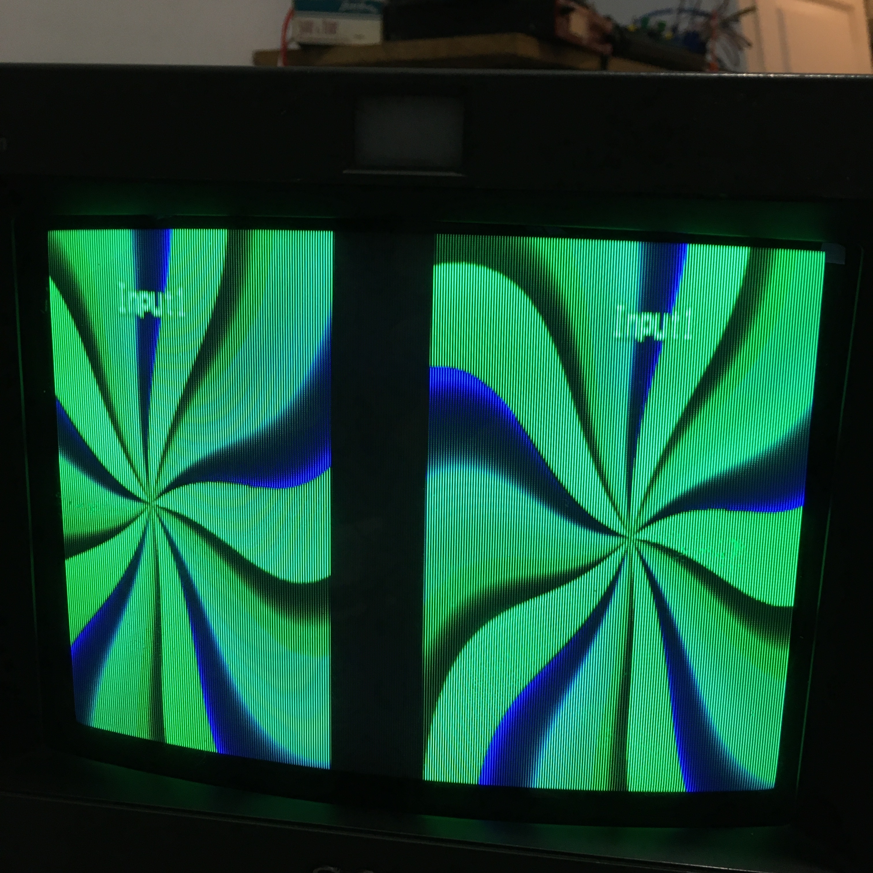

PVM9041QM problem with RGB. S-Vid & Composite are okay
Looks exactly like this, sans the 4:3/16:9 switch.
  • Roland V4 via S-Video or Composite is fine.
  • V4 out to Kramer VP-727 switcher/scaler works well to DVI & VGA on Benq monitor

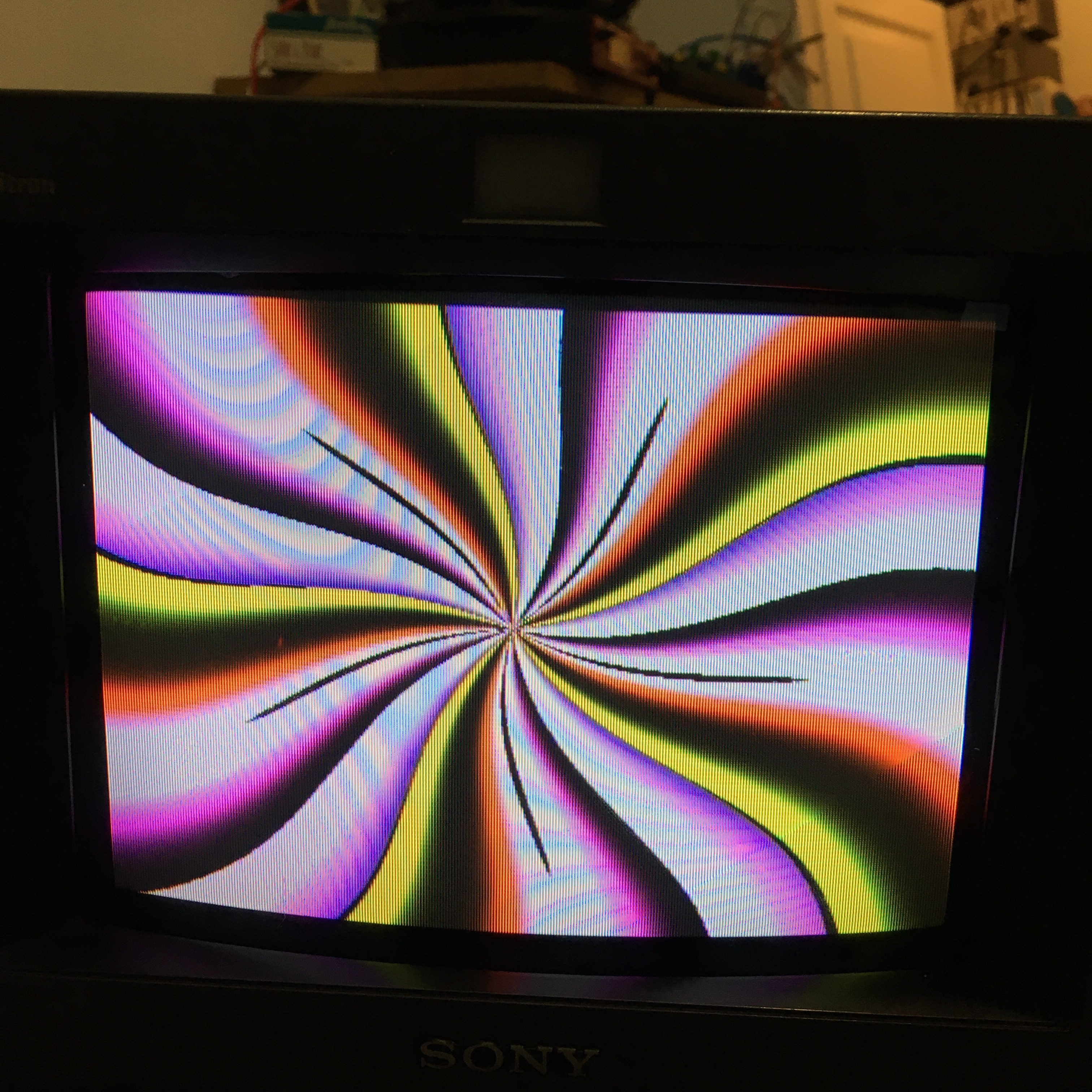

  • Kramer VP-727 via RGB to the 9041QM looks like this (yes, this is V4 Preview output but the result is the same upon the Main output as well.
  • 9041QM switched to RGB input and RGB.
  • Sync set to Internal. External produces a black screen.
  • Similar result (but better color) when switched to RGB input and YPbPr, (or was it the other way around? Either way, it doesn’t work.)
  • Cables eliminated as source of error by swapping out a known good one, one-at-a-time.
  • Every resolution on scaler has been tried.
Link to Kramer VP-727 manual
Link to Sony PVM 9041QM Manual
I had to stop futzing with it as I have an engagement to go to. I figured I’d implore y’all for an assist.
Well I hope I’m wrong but I think I found the problem. It looks like the VP-727 will only output a progressive signal. And I’d be surprised if the Sony accepted progressive.
that’ll do it - you need a converter that outputs interlaced video
Thanks to you both. It’s pretty obvious, once pointed out, that we’re seeing the two interlaced frames. :face_with_diagonal_mouth: I was blind to the readily apparent as the other two outputs (of the scaler) were displaying correctly (DVI & VGA).
