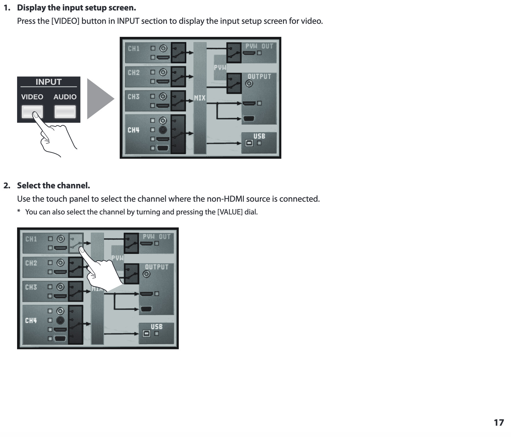

I use a V4EX and do not have any problems using the Visual Cortex as an input into channels 1-3 with a standard RCA to BNC cable. From an initialized state this is the only menu option that needs to be addressed to confirm this configuration:
I don’t use an intensity shuttle, so perhaps you can explore this signal path to identify whether or not its the V4EX or the shuttle causing issues.
Thanks for the tip! Works amazing!
