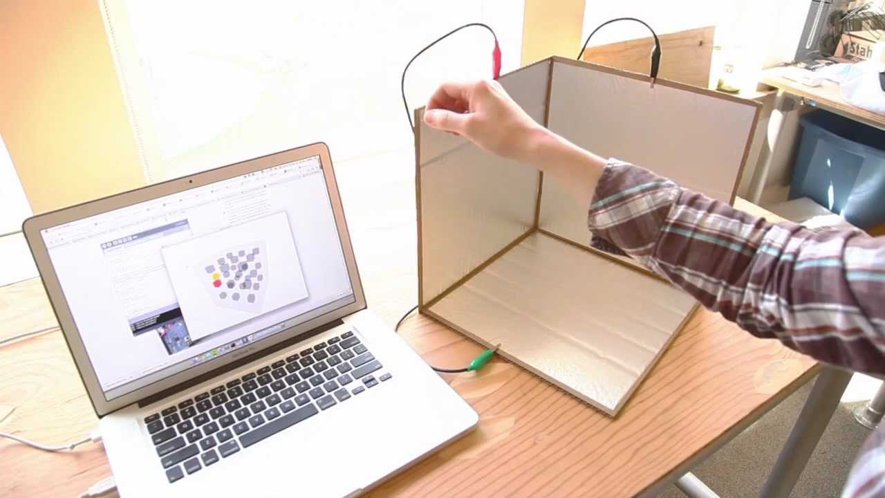

something that has been on the way back burner for me was an XYZ color picker
I think it would be so much fun to have a 3d space to pick color from
something along these lines but not as big
