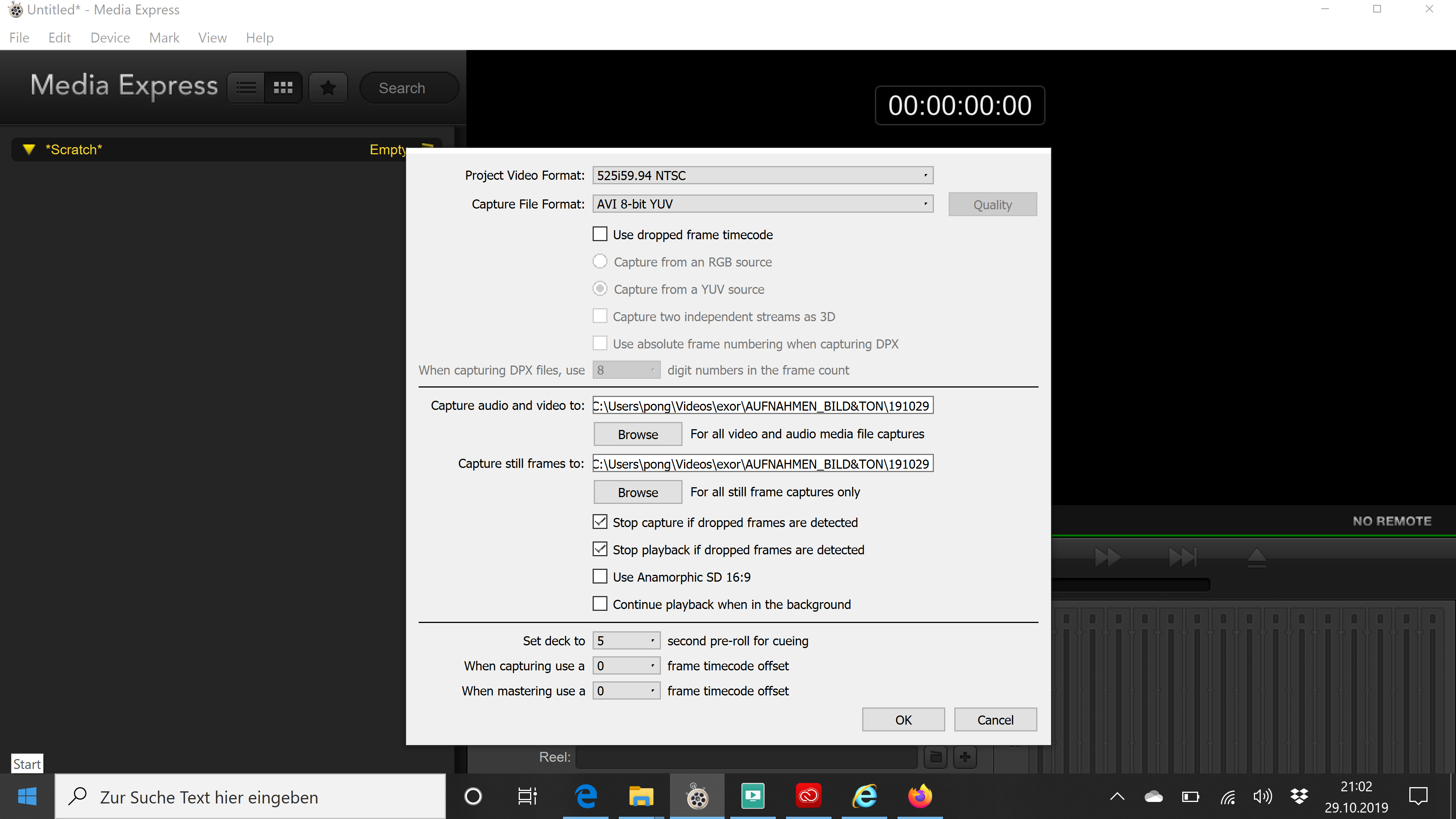

I would suggest editing and exporting at a higher resolution than 720x480. If you have the means to upscale to HD on capture, that is ideal. If not, scale in Premiere when editing.
I’ve never been able to get the upscaling options in Blackmagic software to work at the capture stage. It feels like those options are doing absolutely nothing at all. If I want to enable that, do I need to change my project settings in BM Media Express? I’m still configuring my input on desktop video setup to accept SD video. Maybe the output needs to be set to HD, and then the project settings in Media Express need to reflect that??
I wouldn’t bother upscaling at capture. I prefer to upscale at the “publish” stage, unless I’m upscaling during the compositing stage. That’s how my workflow goes. Yours might be different. Johnny’s might be different. If you work mainly in 1080P, then you should probably convert to that during or soon after capture. Exactly how you do that may not matter much, esp if the end results are the same. This is why I work mainly in SD during production and post-production. It saves me disk space and CPU-time, but YMMV.
Another option might be upscaling before capture, perhaps using a mixer that upscales to 1080. Your options here will depend on the details of your capture process. Mine involves multiple devices which each perform specific roles, like component-to-SDI, SDI->disk, etc. So I can place other devices in my capture workflow, like an upscaler or mixer. E.g. S-Video from VC to V4 mixer, S-Video to component, then to SDI and finally disk. That last part might be a computer with an SDI card or a stand-alone device. I could even convert to HDMI and feed that to a monitor. You get the idea. There are many options!
However, if you use a simple all-in-one capture devices, like the Intensity Shuttle, your options may be more limited but far from simple.
I should add that I started simple and gradually built up the workflow that I now use. So VC to Intensity Shuttle, capture without upscaling should also work. As I don’t have that hardware (I’m not even sure if it was available when I started), I can’t say for sure. However, I’m very sure you can upscale just before uploading. I use a publishing script wrapped around FFMPEG that upscales and adds copyright metadata to prepare the file to be uploaded, but a good video editor should be able to do the same.
