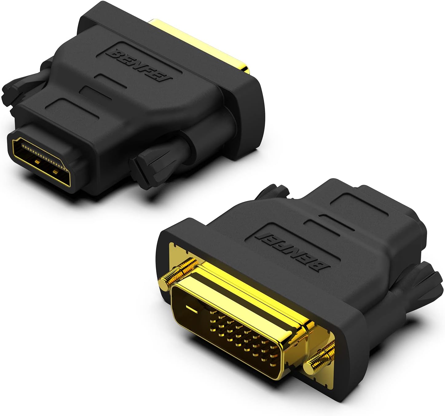

I hope I’m asking this question in a way that isn’t too redundant, or has been already answered. In anticipation of the memory palace’s arrival:
Are there any drawbacks to using a run of the mill dvi-d to HDMI adapter (link to example below) before going I to a recording device (like hyperdeck shuttle ssd) - and out to a monitor?
I 'm all about the high quality conversation from analog to sdi, but my wallet can’t take that big of a hit right now. At the same time, I’m trying to get a recording of a higher quality than can be achieved by USB dongles.
Interested to hear your thoughts on wheather something like this would play nice with memory palace:
