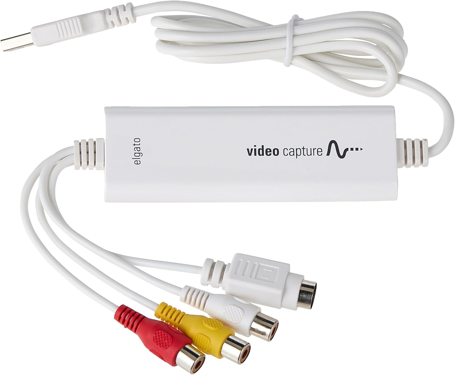

For composite and s-video signals, at Tremendm Labs we prefer the Elgato Video Capture. We use it every week on our stream!

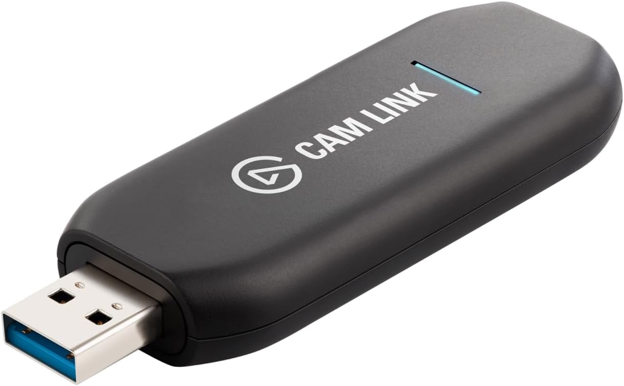

For HDMI signals we use the Elgato Cam Link, which we also use live weekly, but hope to phase it out soon with the Roland V4-EX.
