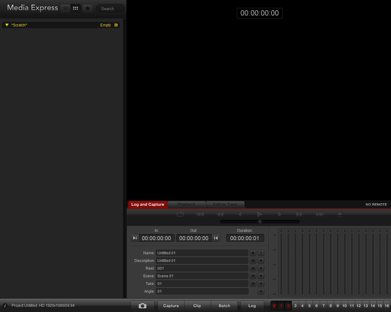

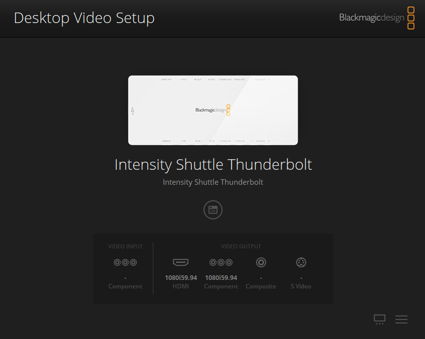

I’ve had my LZX modules sitting in a box for months since I did not have a display solution, but I finally had a chance to get an Intensity Shuttle! yay!
Anyways, I have not been able to get any image from the VC to show up in Media Express yet. I have been able to successfully get an image from a DSLR to show up in Media Express when the Desktop Video input is set to HDMI; however, when I set the Desktop Video input to Component, I do not get any image from the VC. Right now, I just have the H+V output of VC plugged in to the Colorize input of the VC, so I should just be seeing something…
Any troubleshooting tips would be appreciated.
Have you tried changing the Preferences in Media Express? If your VC is set to NTSC, try the 525p23.98 NTSC as Project Video Format.
yes if you were just capturing via HDMI you will need to change via preferences to NTSC or PAL
