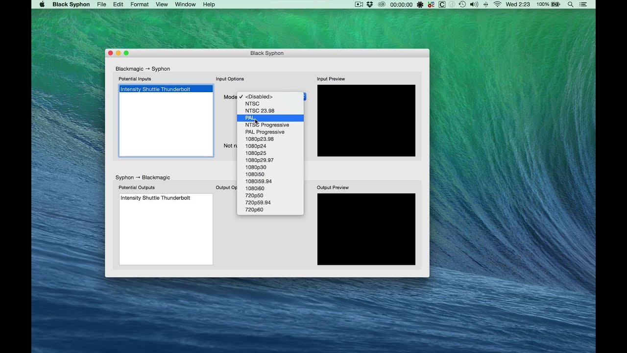

Can you open “Blackmagic Desktop Video Utility?” You will need it to configure which input is active. It took me ages to locate it on my Windows computer. There is also a piece of software, Syphon X, that is only for Mac. Here is a good video that shows both being used:

Media Express is admittedly bad. Maybe using Syphon X will give you better results.

I use the Thunderbolt Intensity Shuttle with an older Mac and it works fine (with Black Syphon; I find the Blackmagic software to be garbage). Though I also mostly use a standalone recording setup these days (Blackmagic Analog to SDI > Blackmagic UpDownCross HD > Blackmagic Video Assist).
