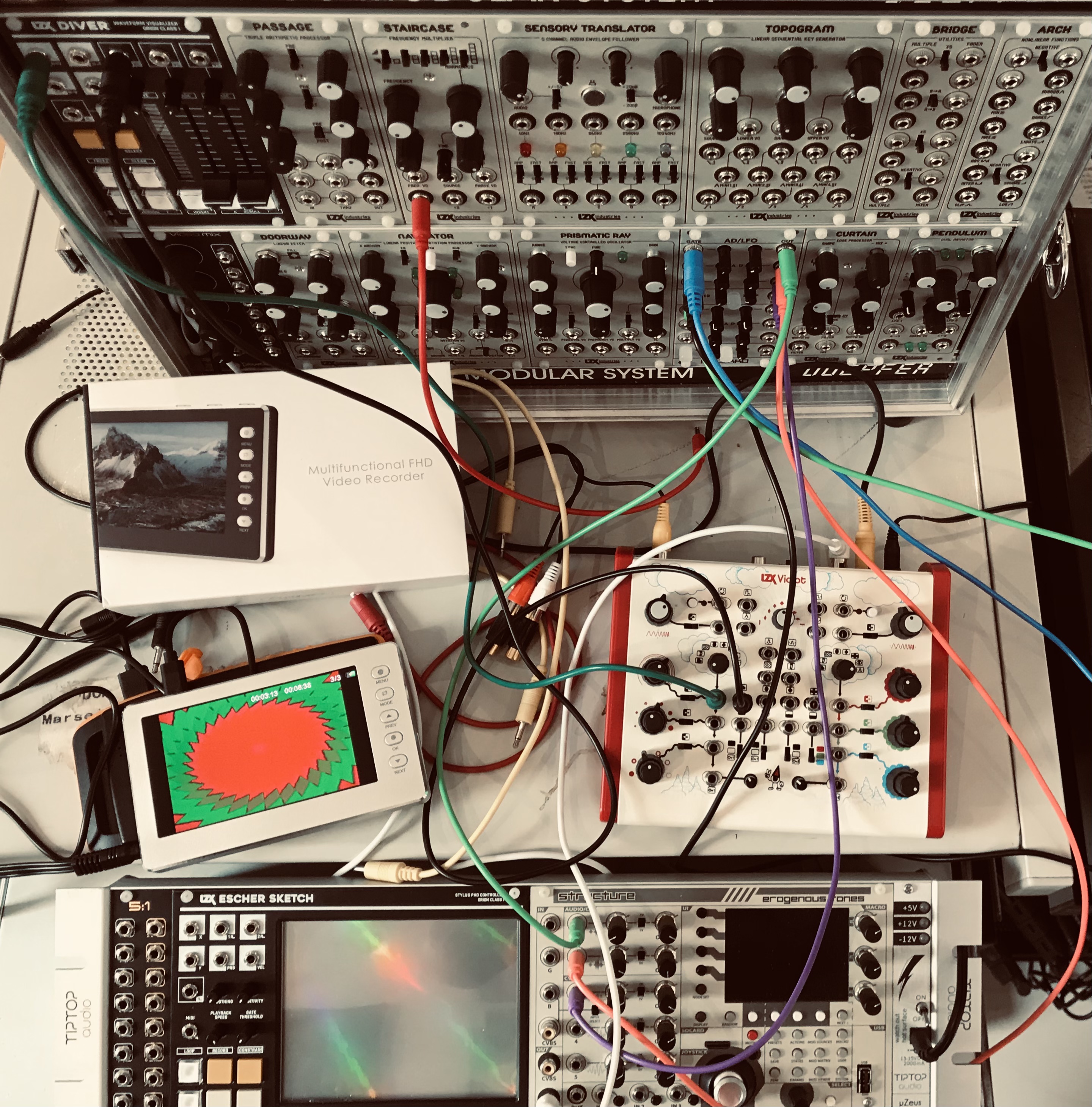

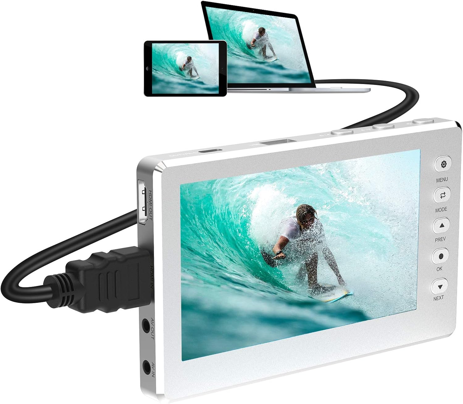

I love this av & HDMI capture box with superb 5" screen. the Internal battery and speakers are rubbish but the captured sound is good and it can be powered with a 5v power-bank.
It is possible to connect another screen on av or HDMI while recording but I did not try this.
it froze a couple of times when I received it but with the right parameters it works like a charm .

Do you have a sample video for that box?
Which is the recording format?
I am not at home so this is to be confirmed, but I think it is .MOV up to 1920x1080 @ 60FPS, H.264 with Linear PCM audio (44.1KHz/16bit).
this is one of my impros recorded with the Digitnow.

Just created an account to ask - how are you getting along with the DIGITNOW capture box since your post? I happened upon this device and there’s very little info in the video synth world - mainly just wondering about stability, as there seems to be a lot of reviews mentioning that it crashes a lot.
Curious about this as well, it seems like a really nice solution but not if it’s crashing often.
