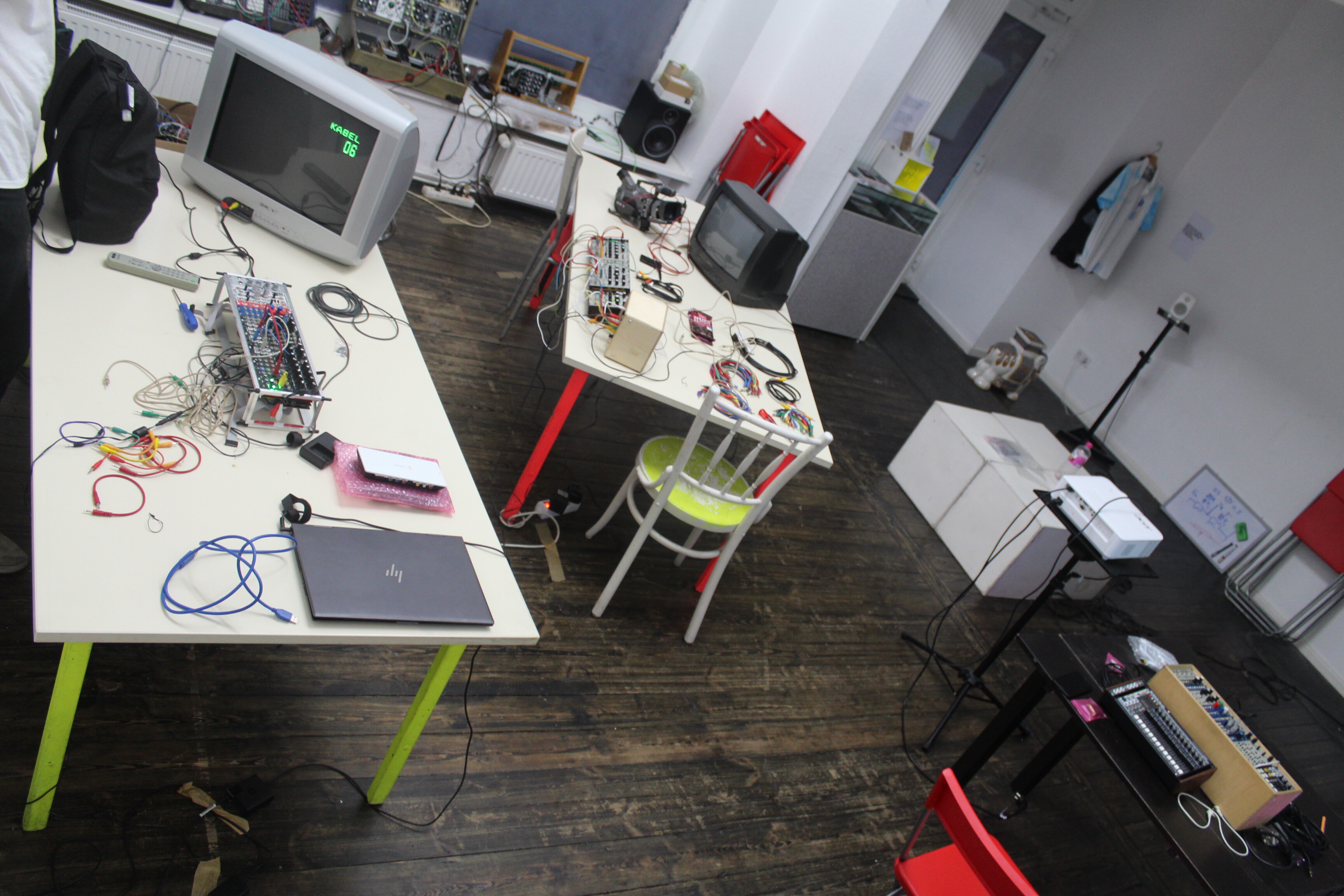

Myself & @cinema.av gave a workshop & Gen3 demonstration in Berlin yesterday evening & used my BlackMagic Intensity Shuttle (USB3 version) with my HP laptop & it worked perfectly fine capturing video with OBS. Evan set it up so it was about 3.1MB per second, about 200MB per minute. I’m sure it was set to 1080p25 PAL via the dip switches.
I hope this helps.
Here’s the CCTV perspective of the workshop once we’d finished :rofl:
