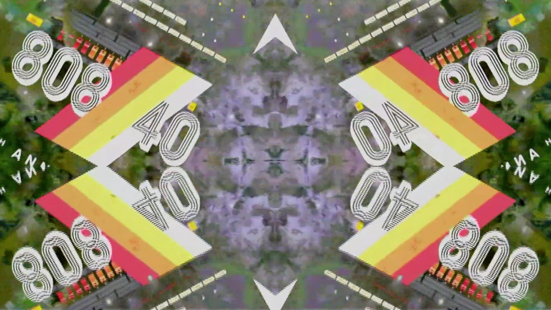

Hey there, I noticed in my DJ stream this weekend, that y Symmtery is inverting not just the image but also the field dominance order too in some cases. So as seen here the lower y mirror still image has stair stepping the the upper does not.
Anyone else encounter this? Something that could be improved in future firmware I wonder?
