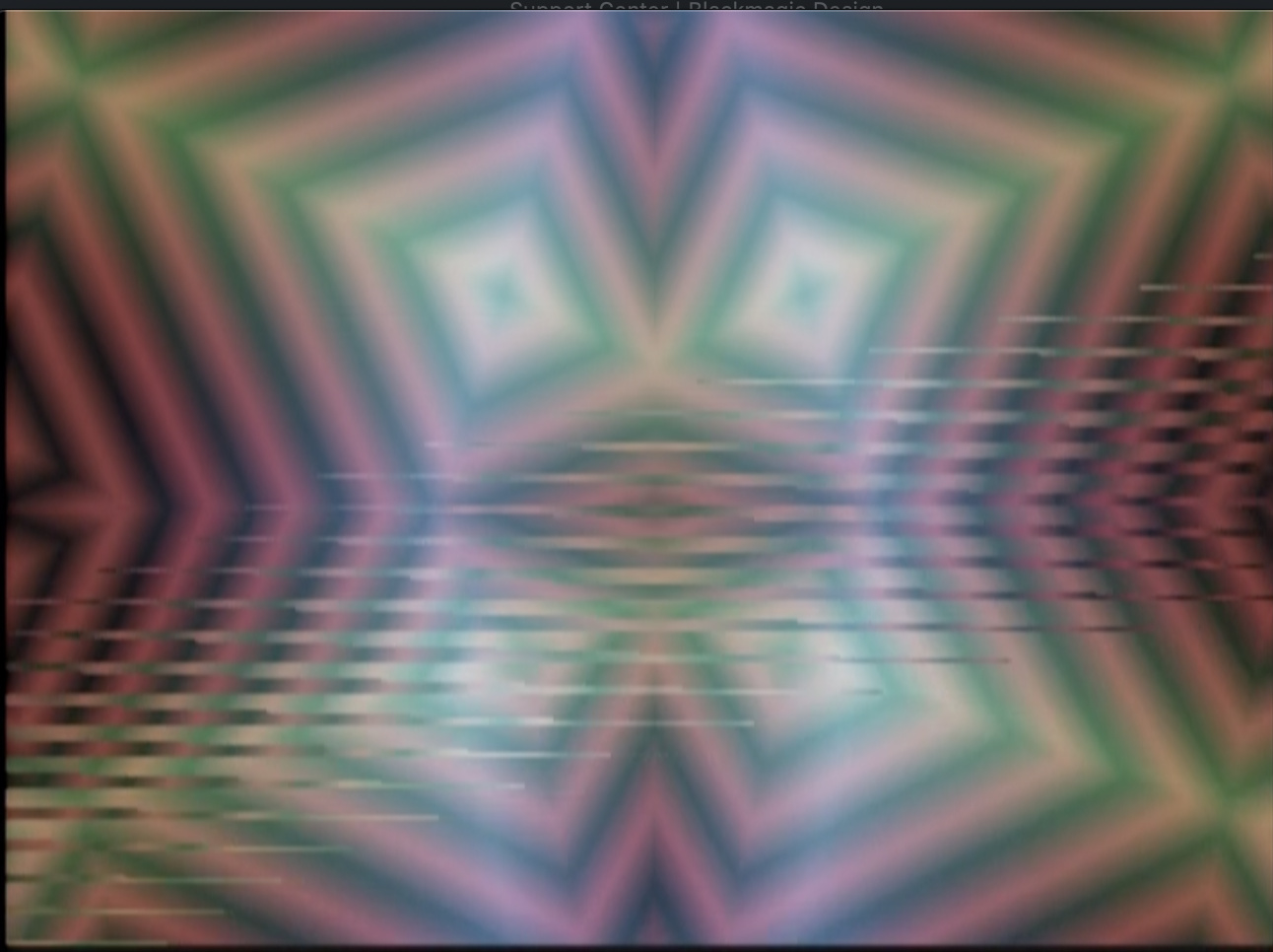

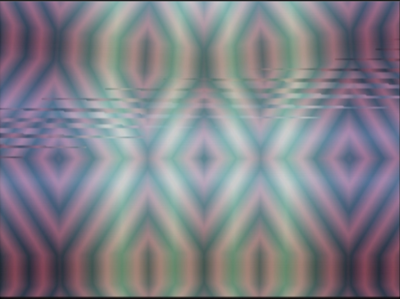

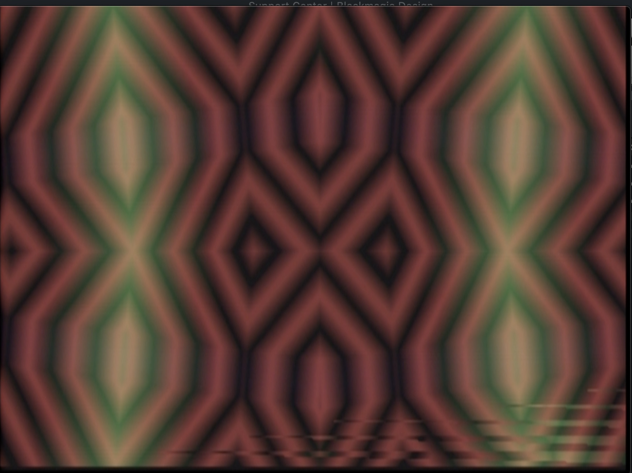

Does anyone know what this glitch with the Memory Palace is? When I am trying to create something smooth and relaxing, this glitch kinda ruins it. It will be running smooth and then gets jerky.
This is a known issue with V19 that will be corrected in V20 (coming soon!). Sorry for the trouble.
