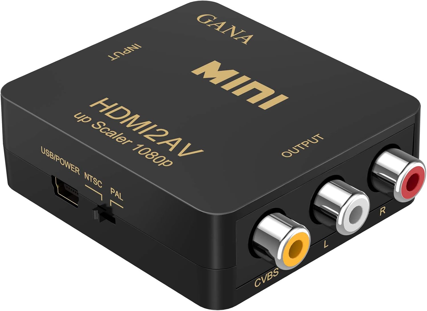

Just spitballing - probably a lightning to HDMI connector and some sort HDMI to composite or HDMI to component box. That would get you started.
The sky is the limit on the HDMI to component/composite part, though! I just linked something cheap.

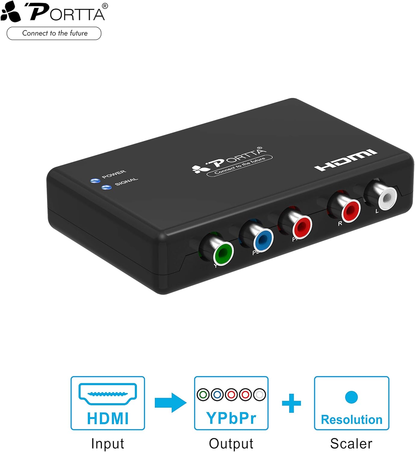

Would probably need something like this to go to the Cortex along with the Apple lightning to HDMI adapter above. With composite, I think you will just get monochromatic.
https://www.amazon.com/Universal-Premium-Quality-Component-Converter/dp/B017LVMAWG
if you want it to lock properly make sure to get one that will scale from what your phone outputs (no idea, personally) to 480i or 576i
This is a good point! The Apple adapter will give 1080p and you want NTSC or PAL for the Cortex.
this one looks good to me
