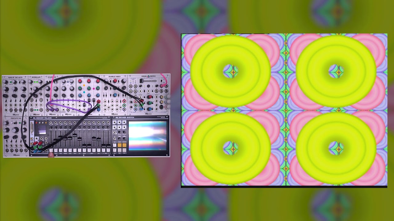

Escher Sketch is the best possible envelope for video because you can “draw” the envelope on the screen and then store it for looping or retriggering.
