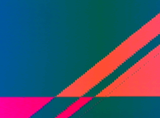

Hi guys,
It seems that I managed to resolve the sync issues of Diver. I use Cadet 1 for sync source. I have no idea about the other sync sources like VC, MP and so on because I don’t have any of them. However, there may be a hint for resolving the issues.

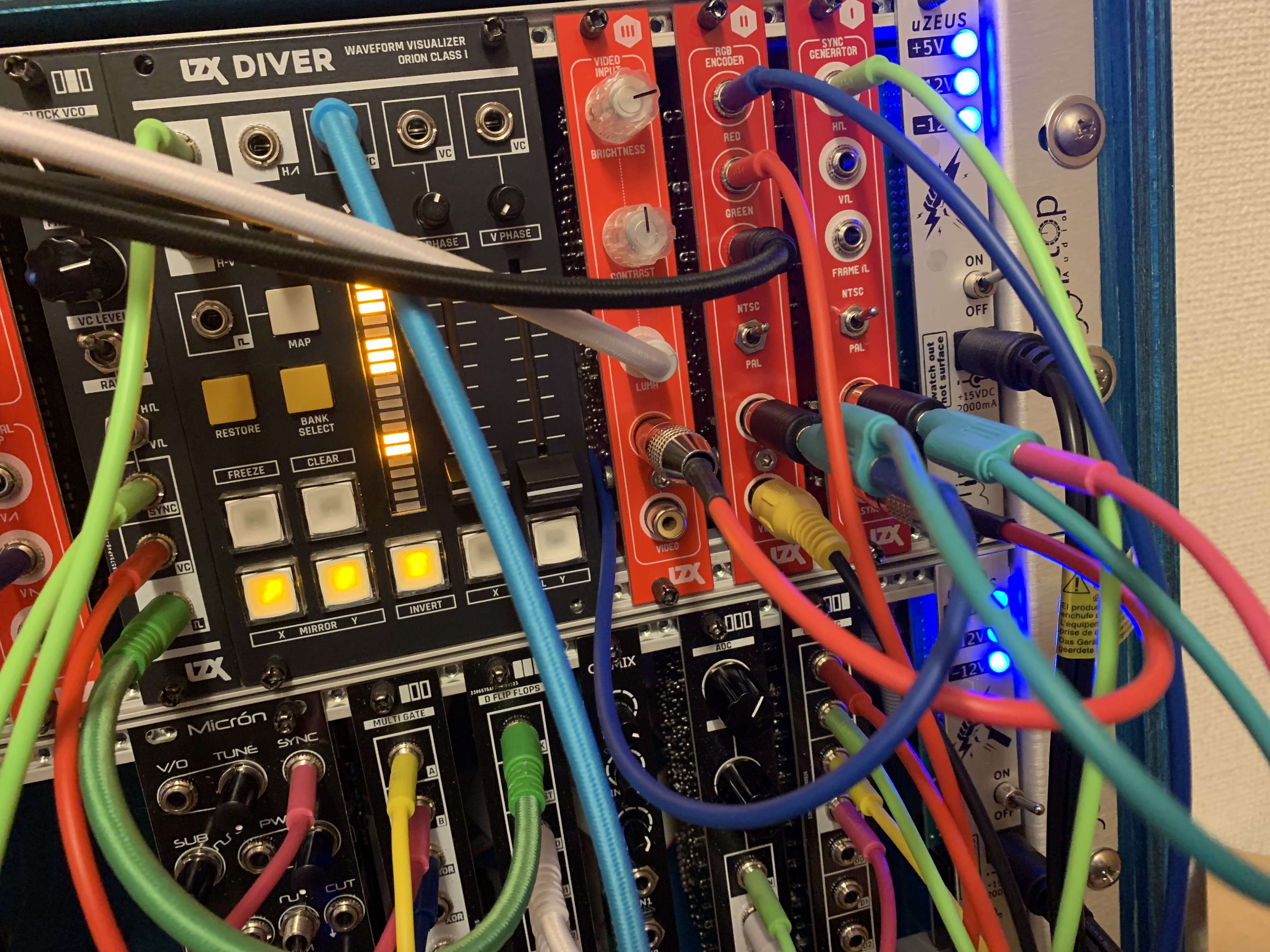

I made sync loops as below, using multiple cables.
Cadet 2 out —> Diver’s loop in
Cadet 2 out —> Cadet 1 sync in
Cadet 1 out —> Cadet 3 in
There are no longer drifting or flickering of Diver’s output. I think the feedback loops might enhanced the sync signals. Perhaps Diver needs stronger signals for sync than in usual installation, I think.
