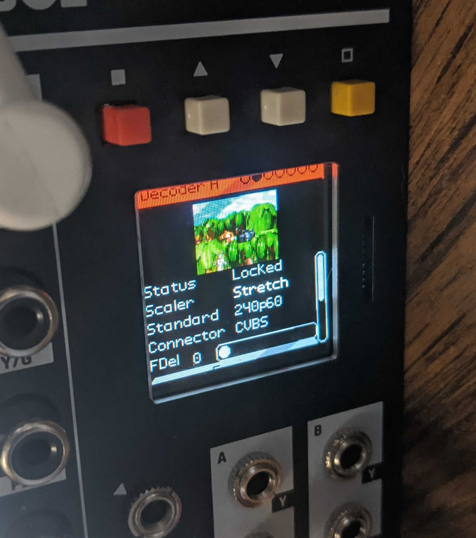

I got it working this morning. It’ll be in the 1.0.1 update.

scaler
and
FDel
these sound like fun parameters to play with!
Lars, you kick ass!!!
Yes there are 4x Scaler Modes: Bypass, Fit, Crop, Stretch.
These are mainly for aspect ratio correction, for example 4:3 to 16:9 and 16:9 to 4:3 upscaling and downscaling scenarios.
Frame delay varies based on the size of the scaler’s output frame buffer. In NTSC, it goes up to 43 frames.
