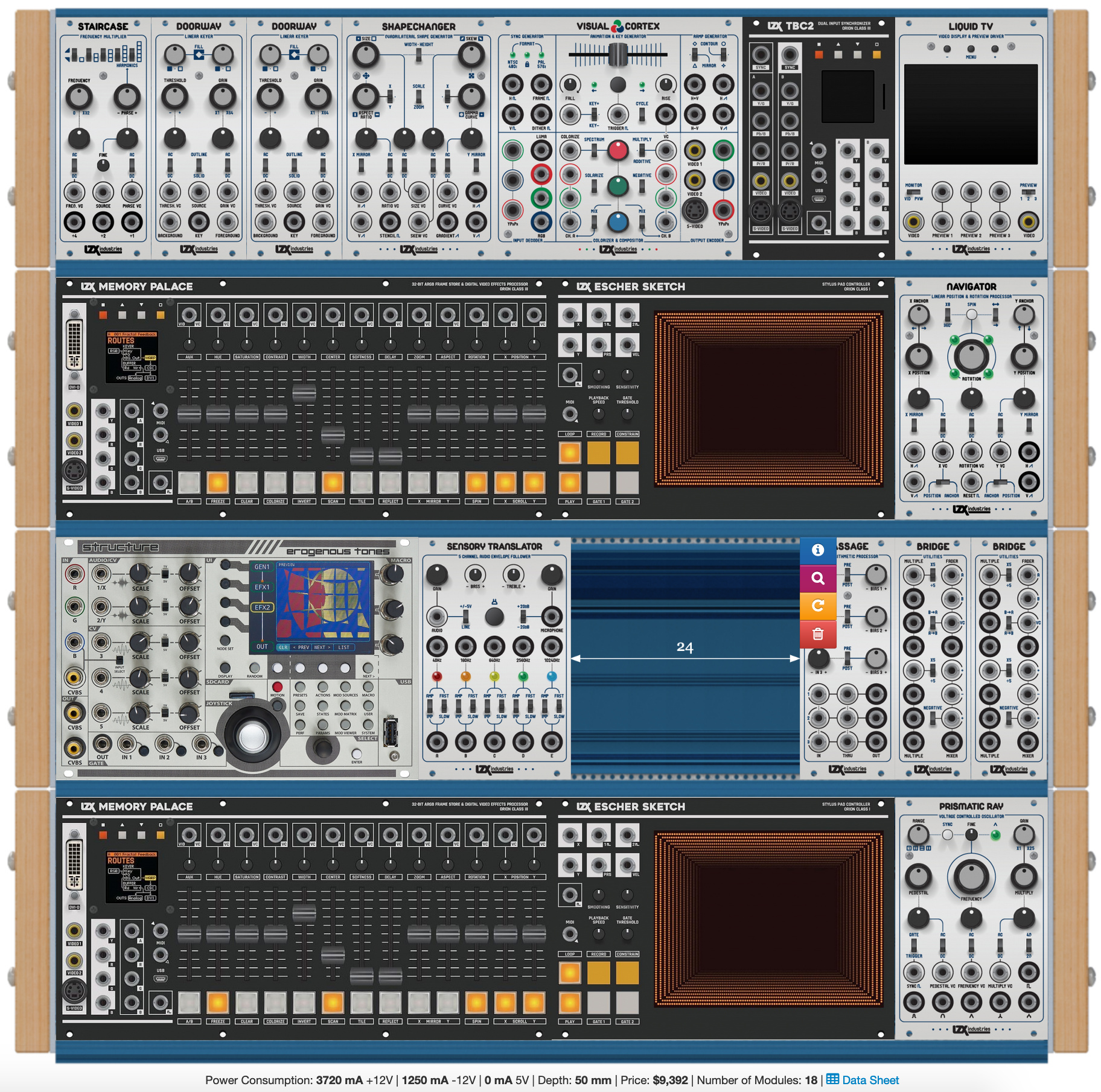

Hello Friends,
I am interested in other perspectives on what hardware might round out this system. I am capturing and processing a live input with the first MP and compositing with the second MP. Structure sometimes titles, sometimes composites, and sometimes outputs directly to a V4EX, which is managing the entire systems mixing and final output before recording.
I feel like I am largely achieving what I want artistically, but would be interested in what sort of utility could be added or improved upon with 24/34/or 50HP of possibility.
(I am currently using Diver in place of the TBC2.)

Interesting stuff! I am thinking about how best to use the space that’s there currently. It seems like within the LZX context, there are a lot of 8/10/&16HP modules. So the space gets filled at 24HP with:
  • 3x 8HP modules
  • 1x 8HP module and 1x 16HP module
If there was some utility in a different but not present 10HP module, I could remove one and fill 34HP with an extra solution of:
  • 1x 8HP module and 1x 16HP module and 1x 10HP module.
Or if not a 10HP module then just a 16HP module to fill 40HP and then:
  • 4x 10HP modules
  • 5x 8HP modules
  • 2x 16HP modules and 1x 8HP module
  • 1x 22HP module and 1x 10HP module and 1x 8HP module
Then obviously, most intense but creates the most opportunity to add another aspect to the system would be also swapping a 16HP module as well to get 50HP and then:
  • 5 x 10HP modules
  • 2 x 16HP modules and 1x 8HP module and 1x 10HP module
    etc.
Anyways, I am chasing rabbits now but I guess what I am wondering is if anyone has any processing ‘blocks’ in their system that they find useful that could fill this 24HP space or so.
Bridge is very useful. Also, BSO scanner is insanely cool. That’s 4hp. Cadet modules are also 4hp.
IMO: playing to maximize HP is a zero-sum game. So many variables and with the current price-point of $ to HP, it’s an unnecessary constraint unless one is completely budget conscious (false economy if one is doing anything with video) or if one has a predetermined case layout optimized for a concrete and specific functional goal like XYZ raster manipulation, or, more significantly, a precise case size dictated by need to travel and gig on the road.
I have total sympathy for wanting everything to fit neatly in symmetrical rows with full row HP optimization. I’ve been playing that game for several years now. Many times I thought I’d unlocked the Rosetta Stone layout for my fleet of Vessels by mocking them up in modulargrid only to find that the limitations of physical realities meant they could not go where I’d hoped. The shallow depth of them meant that many modules (more of the DIY variety) would not fit at all, and the bulkheads for sync and the fan also meant only certain modules can fit near them. That, and the angled walls on the sides meant certain modules can’t sit flush there. Lars got me over my mental block with the explanation that the Vessels are really 84 HP with bonus room on the sides to aid with temperature control and to leave room for back of house sync connections.
All of that is to say, once I stopped striving for perfect/full HP fits, I had a lot less stress.
So, to answer your specific 24 HP question, if it were my case I’d go with Pendulum, Curtain, and RGB pre encoder for VC. All that said, Fortress packs a hell of a punch in 22 HP but good luck filling a 2 HP gap! :wink:

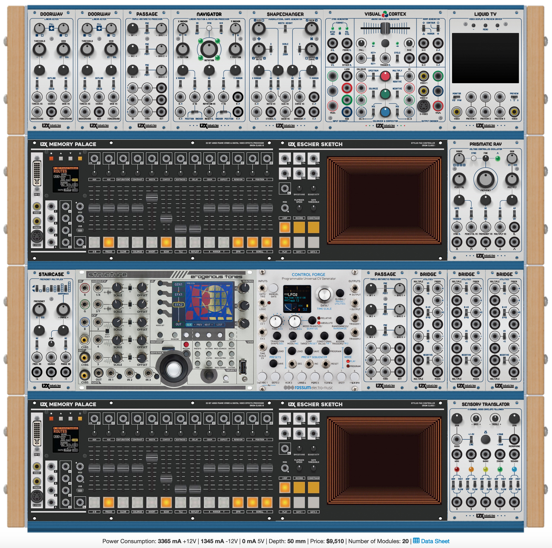

Hello Friends,
Thank you for taking time to talk with me about possibilities! I am going to add the Visual Cortex Expander, and then solve for the remaining space. I am also keeping my eyes out for a Fortress or the forthcoming matrix mixer.
But in the meantime, I removed Diver which was standing in for TBC2 and added another bridge, another passage, and the Rossum Control Forge.
just make sure to keep in mind with the visual cortex expander that it will have to sit right next to the visual cortex (to the right)
at least that is what is recommended
I have a dual MP setup too, it’s the best, super excited for the seams to get fixed in v20, but been working with them for the moment. :crazy_face: :ok_hand:
You might want to consider getting a brownshoesonly 5:1 if you haven’t bought 3 bridges already.
Also you could consider using something else in the place of the second Escher Sketch, as one would probably be enough unless you use it all the time. I’m really satisfied with my Diver, could be a good option.
I’m curious what workflow you have planned for double passages and doorways?
:smile: :vulcan_salute:
