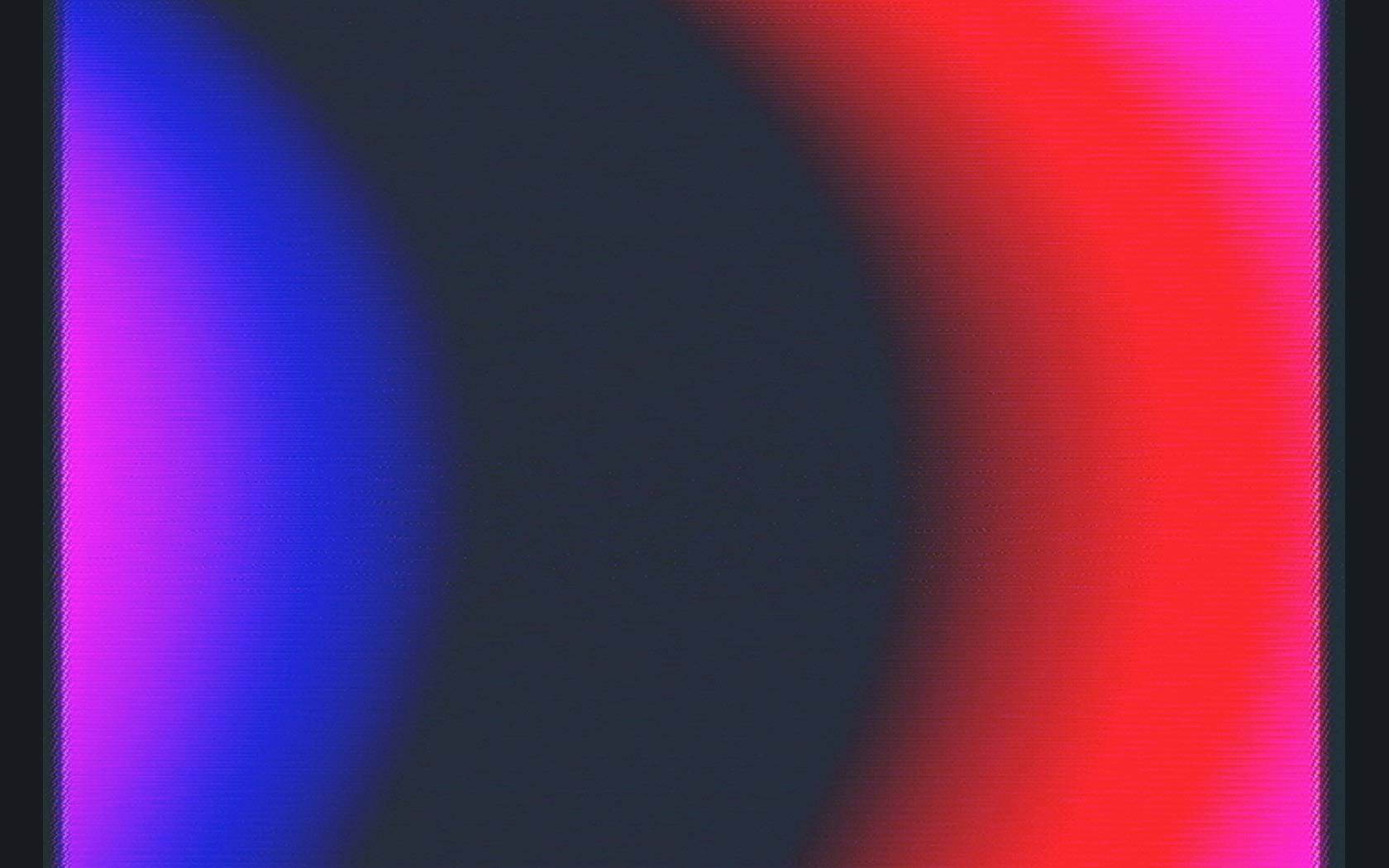

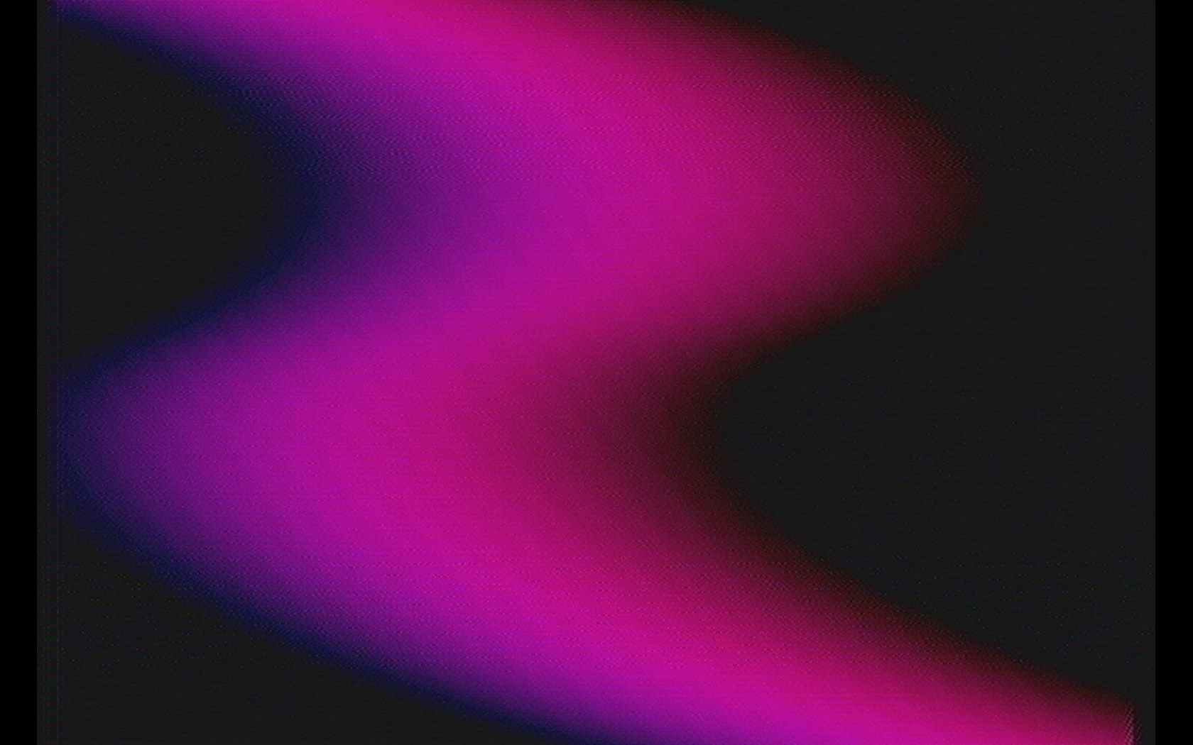

so here is one of my earliest video patches - ramps into self-oscillating multimode filter cv ins and an attempt to sync them (yes obivously these shapes kept on scrolling and only remained somewhat stable using the C1 sync out)
the various filter pole outs (filter module: A-106-6 and A-106-5) were going to C2 rgb encoder inputs
if i meant to create something like that along video lines (:D) what would i need? i have Doorway and Staircase and some color mixing module is on my mind obviously. what is on yours?
