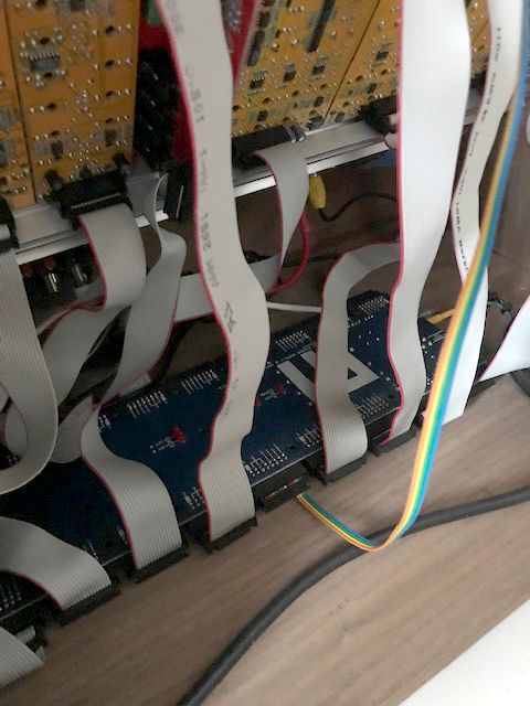

If you’re careful and the cable is not too long (this one is about 12-18 inches, you can make a jumper for sync to whatever bus you need
