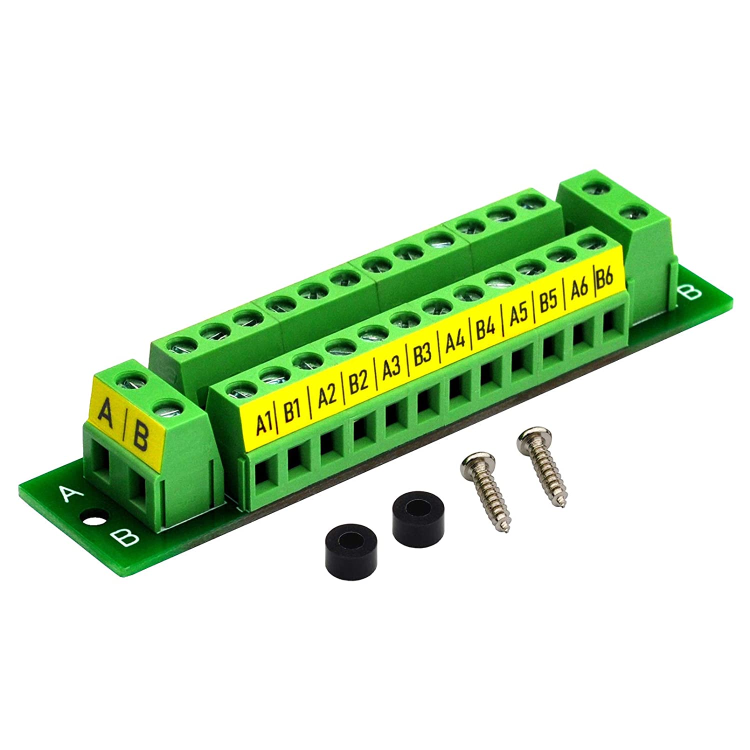

bus bar - screwed into case (its wood, used screws included)

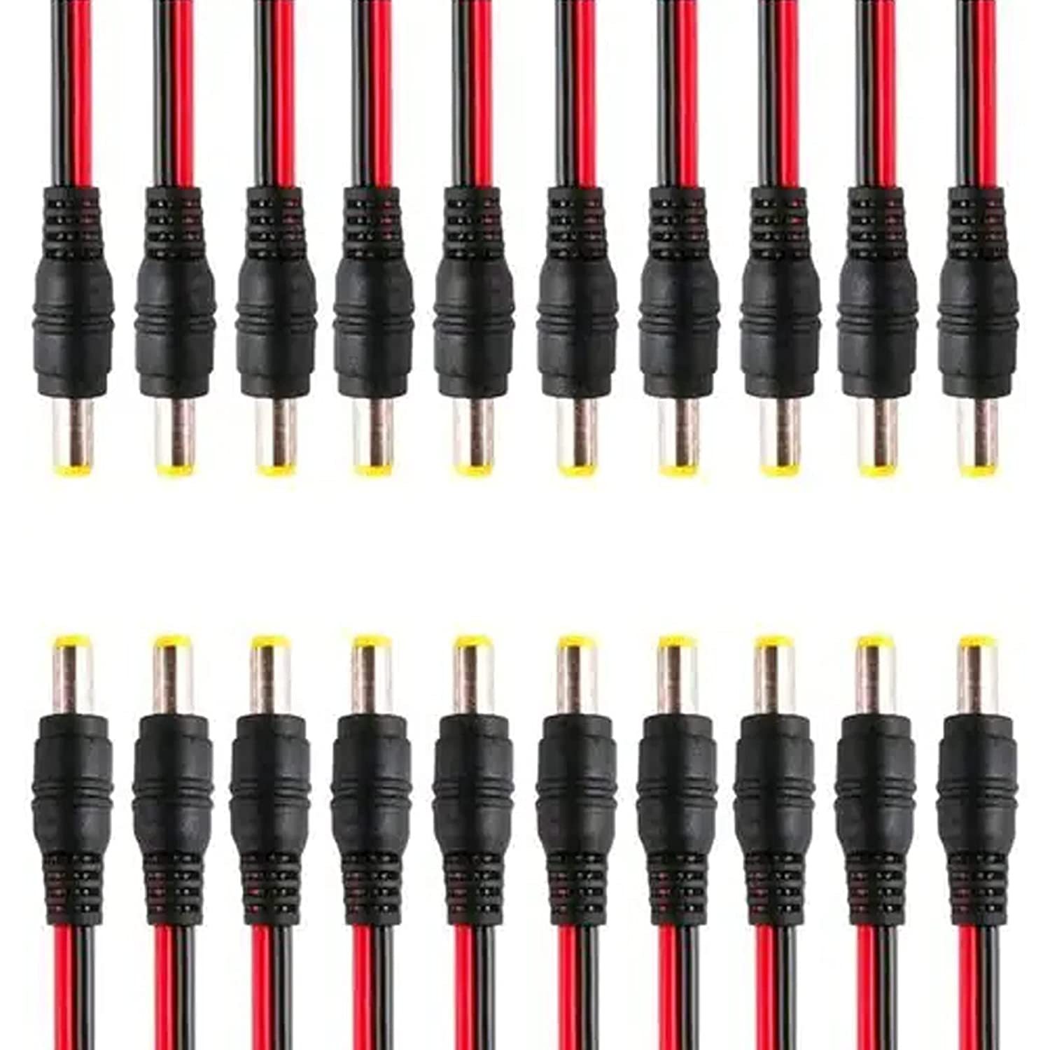

pre made tails- (could make your own, see last link)
im sure there are better 12v 2.1 hoodas but i felt these were decent copper quality (?)
