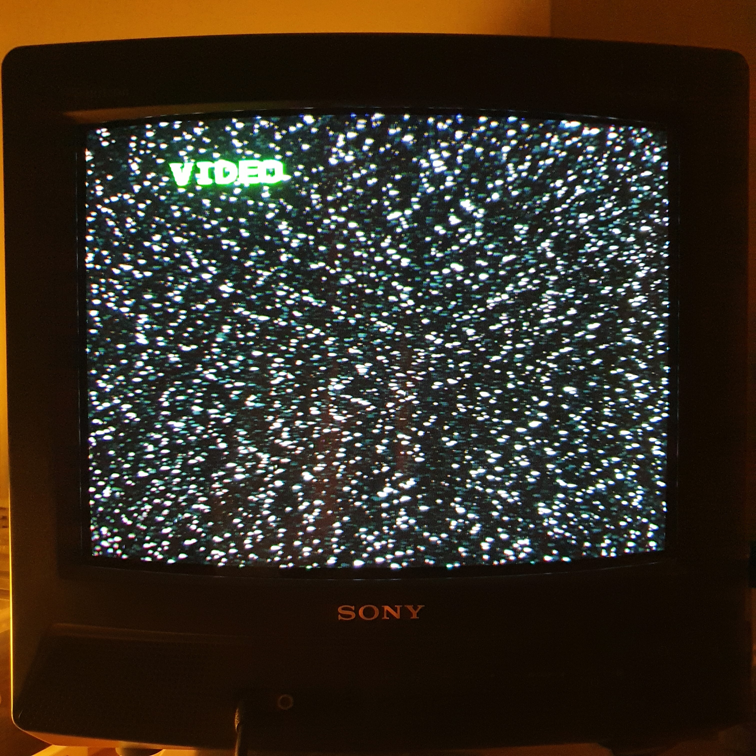

SNOW standalone test
I just tested SNOW directly on a CRT monitor with a monojack to RCA converter plug.
It works good. the snow image looks more fuzzy (which is actually very pretty)
a few remarks:
-the offset potmeters only do something when you use the comparator output (I think the offset is cut from the signal at the CRT input?)
-the comparator output does not go fully white (snowstorm) so you might have to change some capacitor & resistor values
The comparator output has some difference . it can go from dots to lines at some settings.
at extreme settings the lines get a harsher look.
so those are new features!
