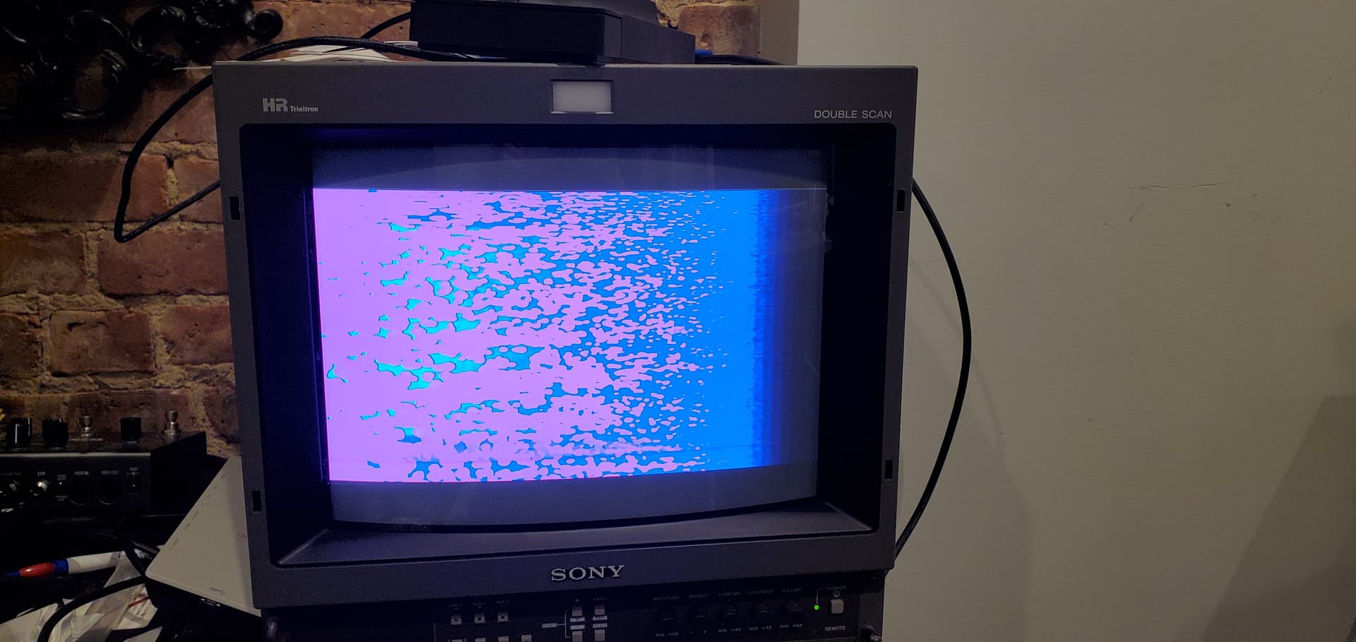

Sony trini phms. Can ONLY do HD component video. Will not display 480 over component so no cortex or ambry component converter plus composite signal
Some hd v440 feedback
