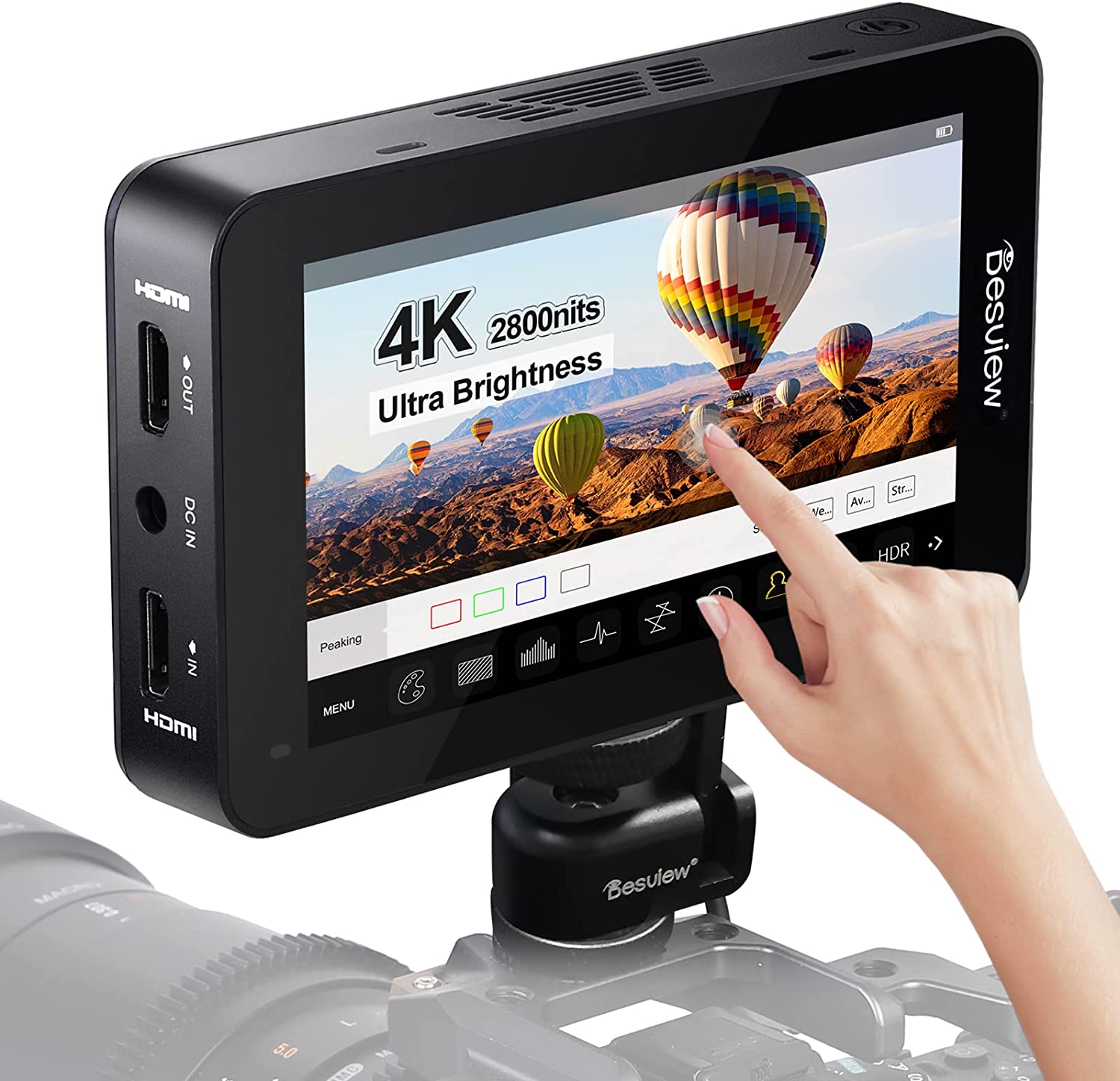

Anyone tried Feelworld?
The promo graphic for this 5.5 inch monitor is an amazing photoshop scale error :rofl:
