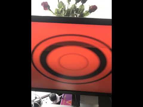

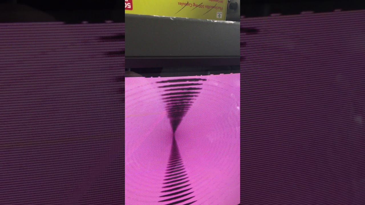

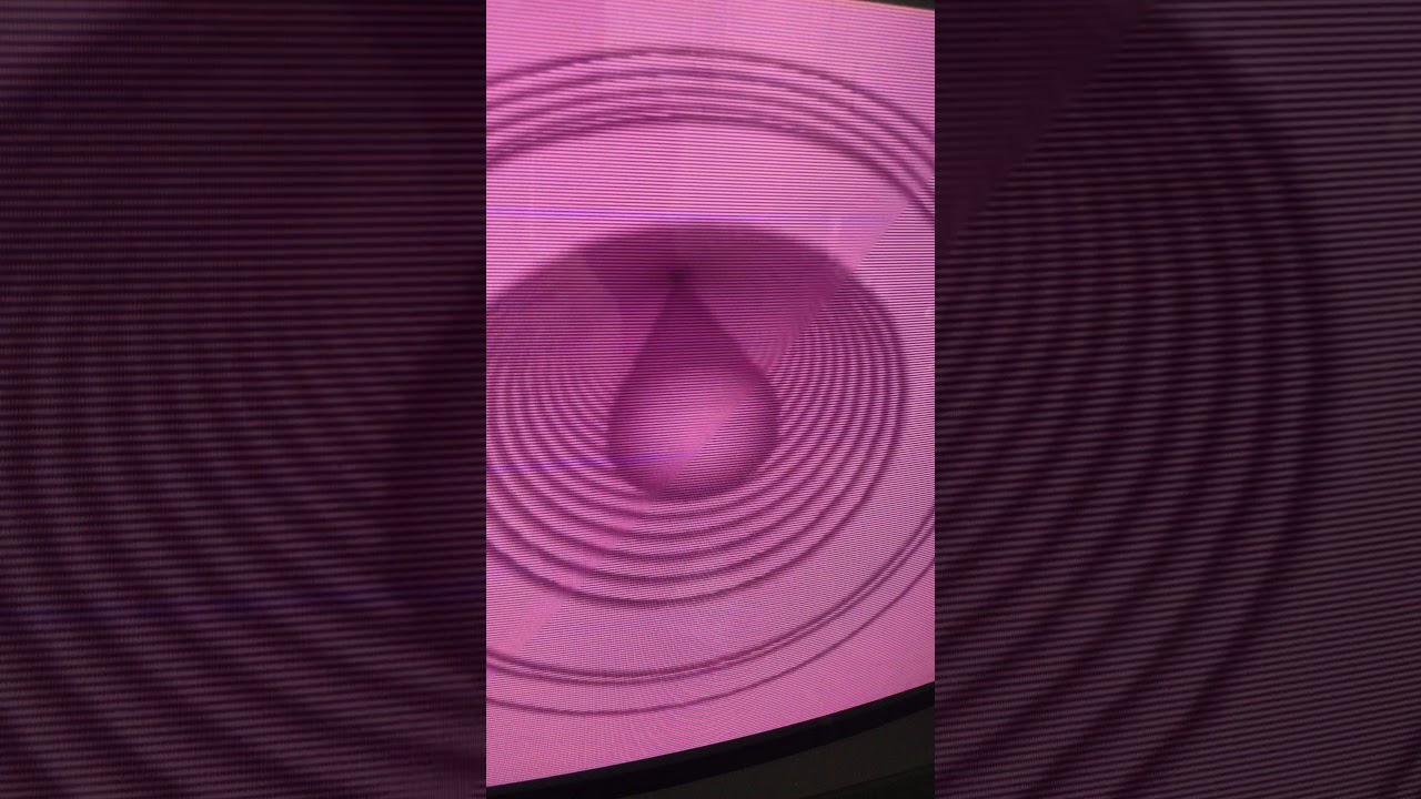

There is quite a noticeable amount of ‘oscillation’, which seems to be much stronger in the middle of my display (PVM).
I am also outputting to a digital monitor using the DVI Out / supploed HDMI Converter, where this oscillation is again present, but also whenever there is any movement on screen (e.g, threshold change on Doorway) the top third of the screen is overcome with thin horizontal lines, and there is often a flickering and a delay before the display ‘catches up’. The Delay Slider (44) is all the way down.

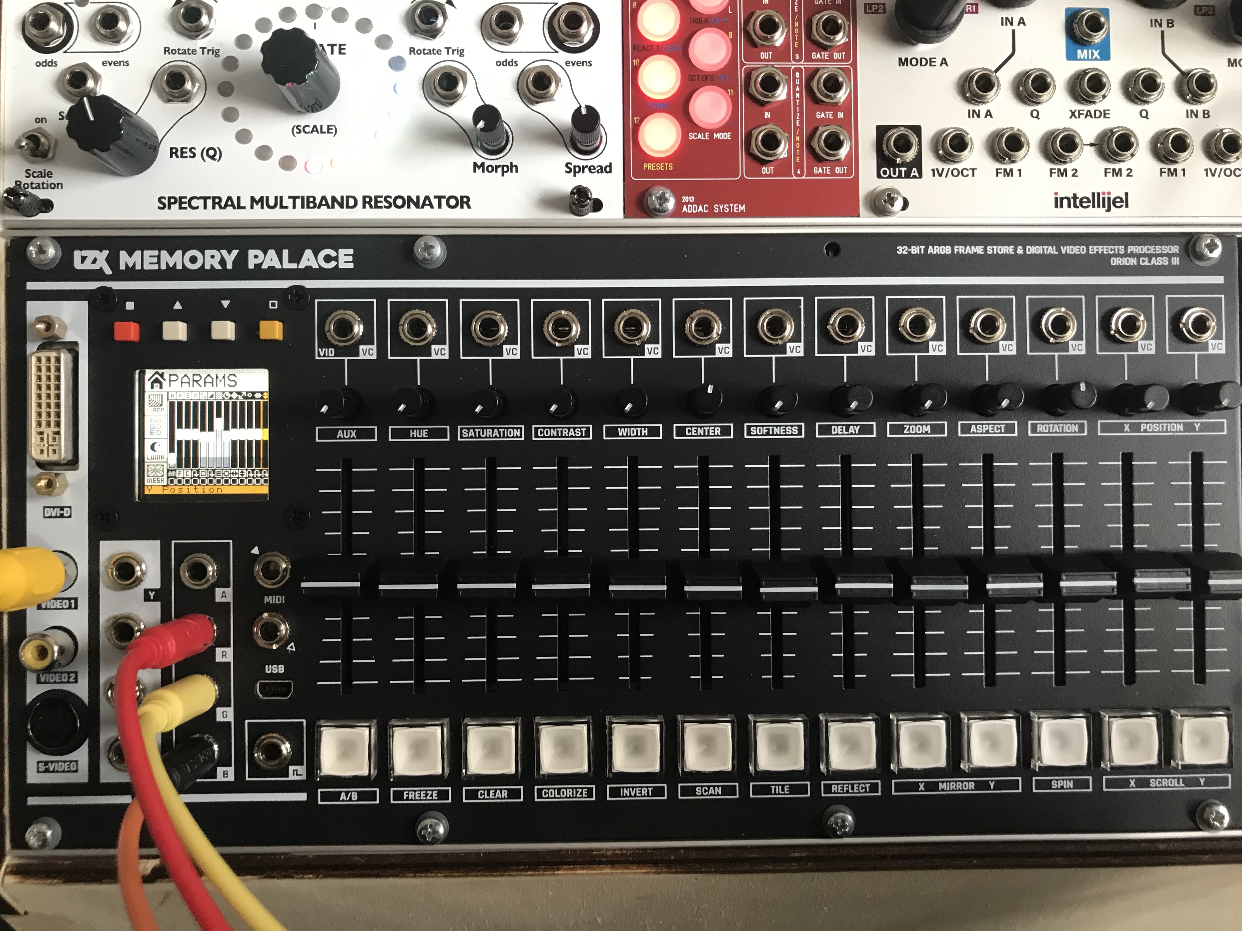

Lastly (and I’m not sure if this is just a default setting) if I center the physical Softness Slider, it is not centered on the Display.

“Lastly (and I’m not sure if this is just a default setting) if I center the physical Softness Slider, it is not centered on the Display.”
Could you share a photo of the display when the softness slider is centered? Have you tried restoring defaults in the menu?

Softness Setting - Can see the slider is noticeably higher than the others in the display
I have tried restoring to defaults
Oscillation on monitor using DVI Out
Oscillation on PVM using CVBS output

@Z0NK0UT Any ideas why the softness slider is much higher on the display? :face_with_monocle:
That’s a V19 bug. Already fixed in upcoming V20 revision.
