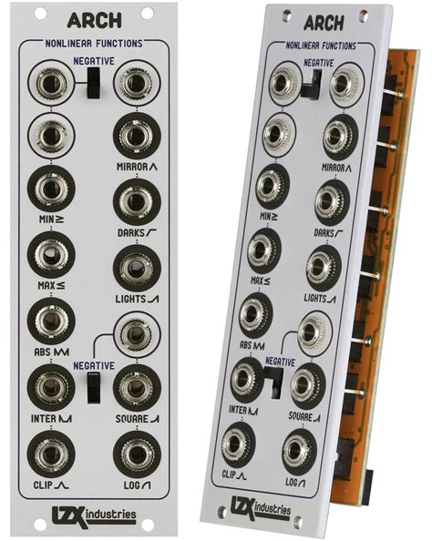

Damn - the only one I never picked up. Yeah, I can see it clearly as a logic function just from those inputs, thank you. Looks like I have to get a DSG3 if I want the Arch function - can’t see there’s any other modules planned for that, though a new DIY Arch without the ramps of DSG3 would open up lots of possibilities.
Not sure whatever became of this project: [WIP] Analog Logic
Hopefully will come to fruition at some point!

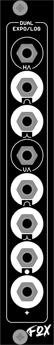

I think this might be a relevant module too:
And this:
https://syntonie.fr/produit/vu002-quad-frequency-doubler/

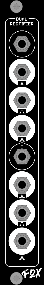

GAMMA covers the lower right hand section of Arch.
There’s also RECT which covers the upper right hand section of Arch.
Ah! Yes, I thought there was another one, but forgot which it was.
