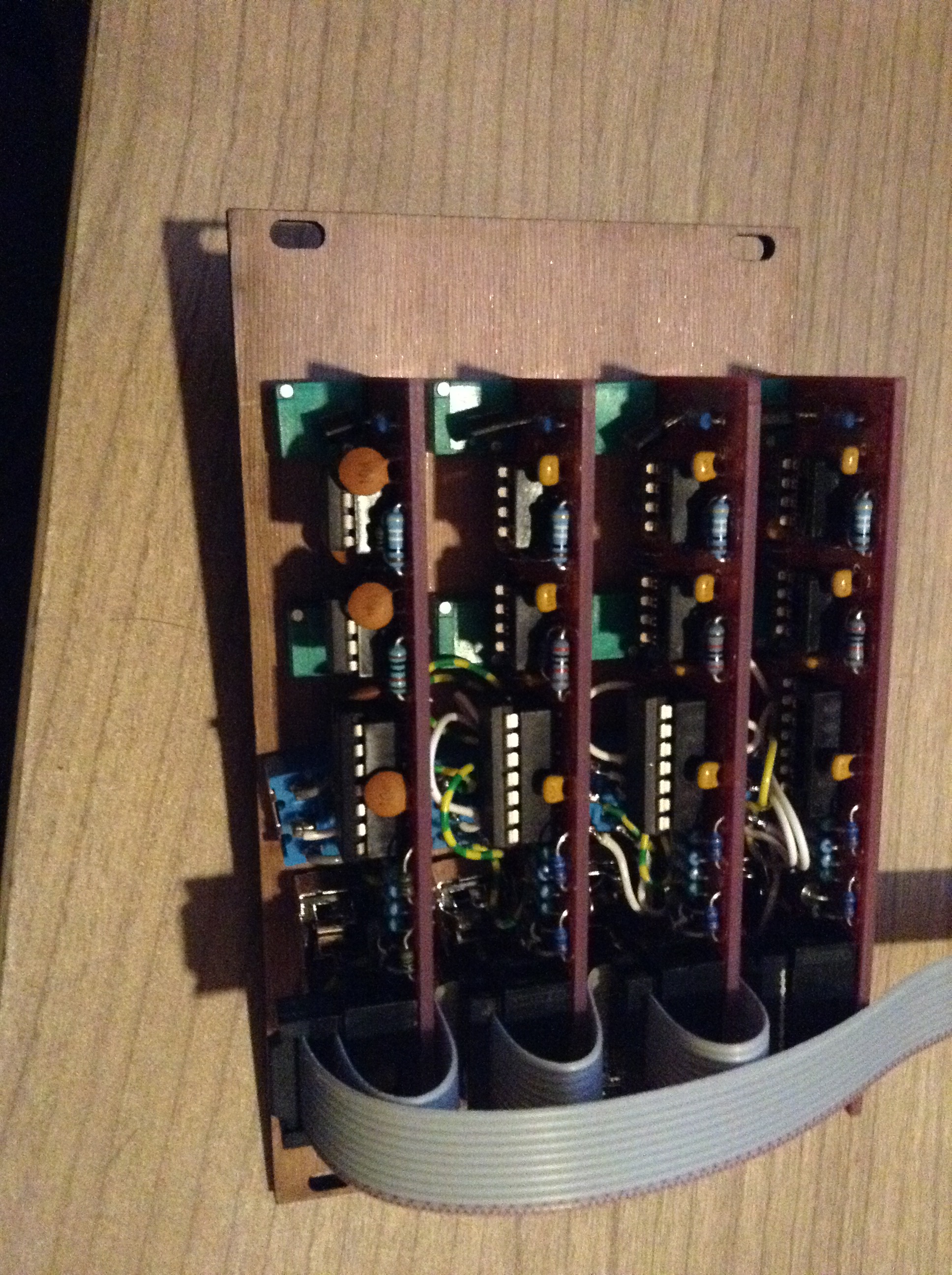

Tower of Flop
Finally wired all three of the flipflops. This effect is really cool. so 3 is better :slight_smile:
Next up is the Tower of Shift (pcb’s are done, wiring not so much)
