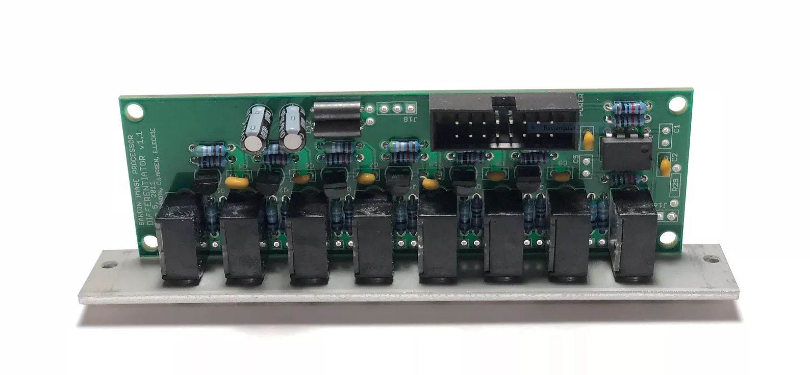

Does anyone have a part number for the 3.5 mm jacks on the Differentiator? I do not see any obvious matches at digikey or mouser.
These seem to be the ones. I have some on hand but have not yet soldered them in to be 100.00% sure:
https://www.digikey.com/product-detail/en/35RAPC2AV/SC1457-ND/772080

Also, @creatorlars, there are some legends on the board that don’t have BOM entries:
  • R29
  • C1
  • C5
I ASSume these are DNP, but it’s always good to confirm.

Those legends are for the Differentiator, in case I wasn’t clear. :slight_smile:

I stumbled upon a photo of a built unit with all three of those designators showing up as DNP. Since the project was originally pre-built or DIY the photo could be a little off.
Also looks like you got the jack selection dead on.
Nice sleuthing, @JunkRhythm – thanks!

I remember now. Those are all DNP. The two caps are in parallel with the feedback resistors for the summing amp. You could put something very small there (2pF) if you noticed any ringing. Or something large there if you wanted to intentionally soften the outputs (turning it into a kind of bandpass filter almost.) The extra resistor placement was for adaptation as a replacement board for an original Sandin IP system, where I/Os were 75 ohm driven and terminated. So I’m guessing it’s a gain setting resistor for the output (to drive at 75 ohms, you would want 2X gain.)
