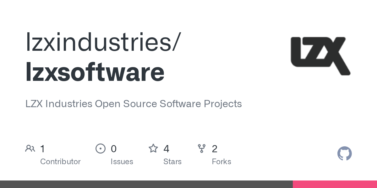

As requested, I have archived the project and source files in their existing states for Diver & Escher Sketch in the public facing repository here:
The next step for this repository would be to convert the projects to remove dependencies on VisualGDB and document a more open build toolchain. Additionally, instructions for debugger access to the hardware should be documented.
