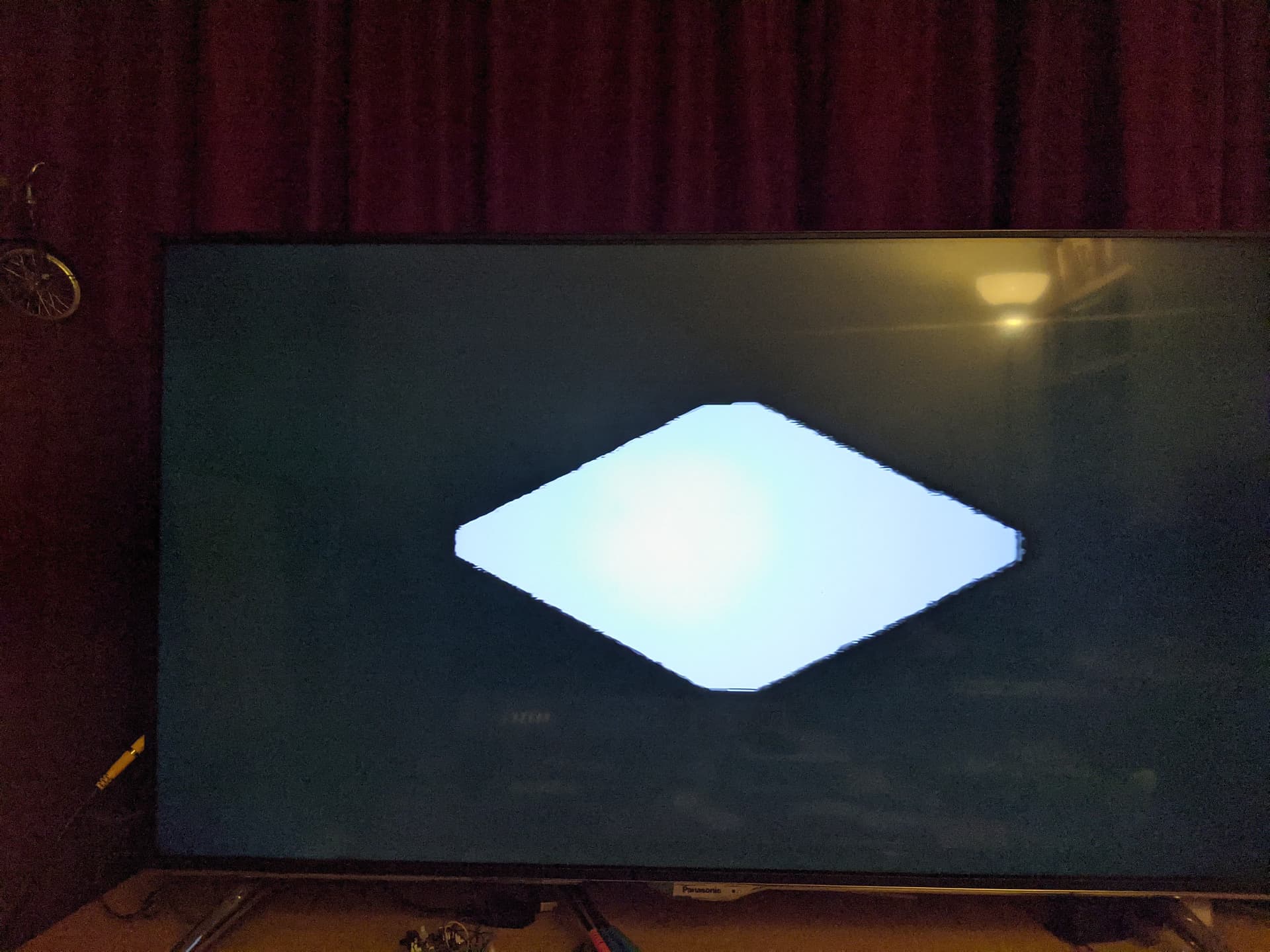

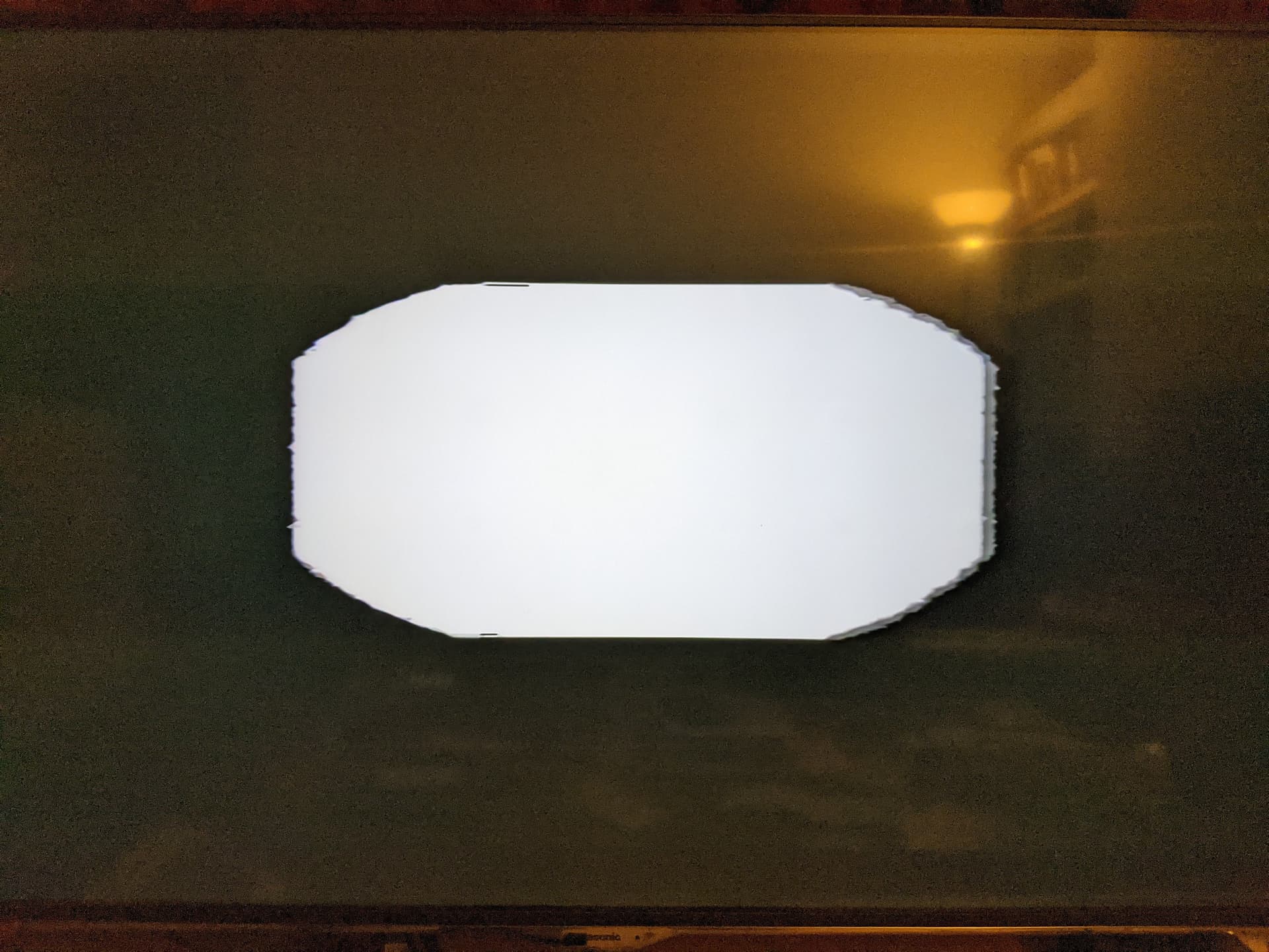

The weirdest thing about Diver, for me, is that the ramps are the wrong shape. Well that and the vertical line discontinuity 2/3 of the way across the screen from the left.
All of the ramp shapes have squared off sides.
The circle has square edges. So does the diamond and the expo diamond.
If you key them down, they get more squared as they get smaller.
I’ve never really noticed anybody discussing this before.
I don’t know if it’s because my system is PAL.
The images are a keyed triangle ramp and a keyed circle ramp.
Cheers!

OK, that’s definitely an issue to look at! Are these outputs coming directly from the H+V and H-V? Or are you sending the H & V elsewhere (like Shapechanger) to make the shape?
These modes on Diver weren’t intended for shape generation that wasn’t also kind of abstract and under modulation from audio, but I can see why you’d want to use them this way. For shape generation you ideally have a quadrilateral high gain function (ramp cropping, like Shapechanger and Chromagnon) if you are wanting to make the shape bigger or smaller. So maybe we just need some “clean shape modes” where you have Shape Width + Height on the sliders instead of the phase. Or some fixed size hard shape output modes, as mentioned above.
Those outputs are coming straight out of the Diver H+V outputs and into the keyer of the Cortex.
Even when the shapes are around their largest on screen, they still have squared sides.
I am going to bet this has to do with issue #2, I’m beginning to see the pattern ultimately leading back to a consistent phase offset.
A very helpful question right now: Do any of you not see the issue present in issue #2 on your Diver? If so please describe your sync setup.
