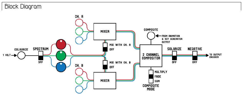

So I’m starting to user more and more the colorizer VC input in my VC and I love it. Reading the block diagram on the VC tech manual gives me an grasp on what it does, and I wanted to use another colorizer within my system (i.e. in a submix on a second channel).

Passage -> Marble Index is the most literal route to go here. This gives you a brightness/contrast control over each color, and the ability to send the a single input to all 3x outputs, each with their own bias/gain controls, the ability to sum in another voltage (i.e. brightness modulation) on each color separately, and then advanced composites/blending, fader controls (via Marble Index’s compositors.)
The “Spectrum” mode is something special, that only appears in Cortex. It is a waveshaping based Colorizer. You could think of Staircase as the more advanced version of it, if feeding the Staircase outputs into RGB.
