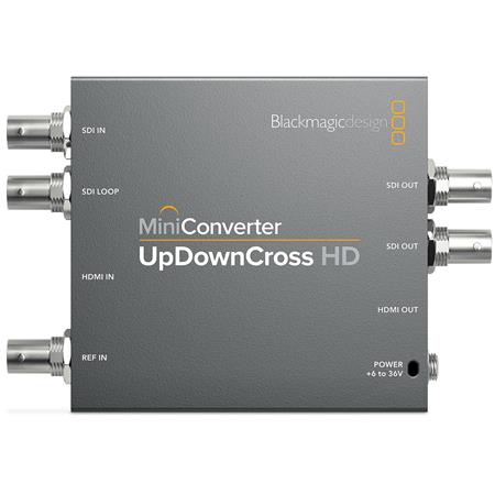

This:
+++plus—> updowncross

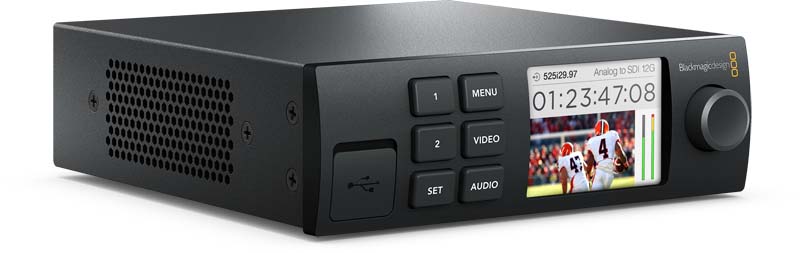

Versus:
If you haven’t already, you should also look at their SDI->HDMI micro converter.
Oh! I just noticed that the Mini Converter UpDownCross HD model has an HDMI output. I’d not known this before today. Thanks.

If it matters, I think the UpDownCross is only 3G (1080p?), and the Teranex Mini is 12G (4K?). So a little more future-proofing with the latter.

The Teranex Mini’s UHD option is only for upscaling incoming HD analog video, however, and the manual is not specific at all about what “HD” and “UHD” formats they are, exactly.
I’m leaning toward the mini analog->SDI + UpDownCross HD.
I like this option because if you were to go into the 4k realm your updowncross HD could just get replaced with an SDI => 4k and you would be good to go
