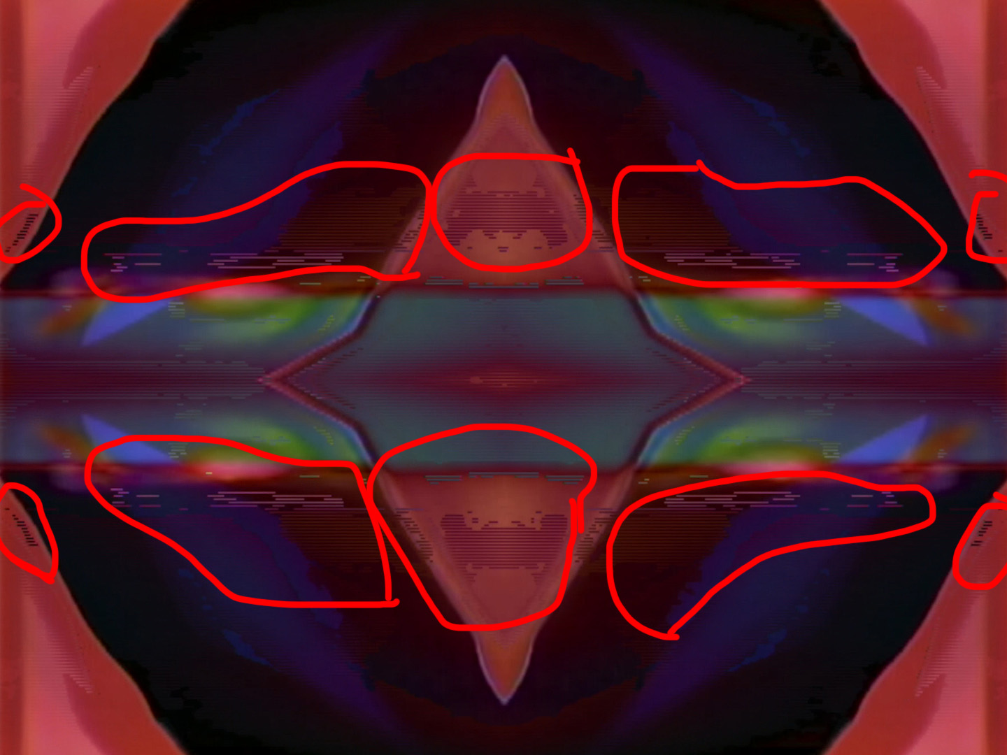

Can any one recommend a converter that takes composite RCA or s-video and outputs HDMI? I usually run my system through an Edirol V4, and have been using a Roland VC-1-SC scan converter, but get all these awful interlacing artifacts.

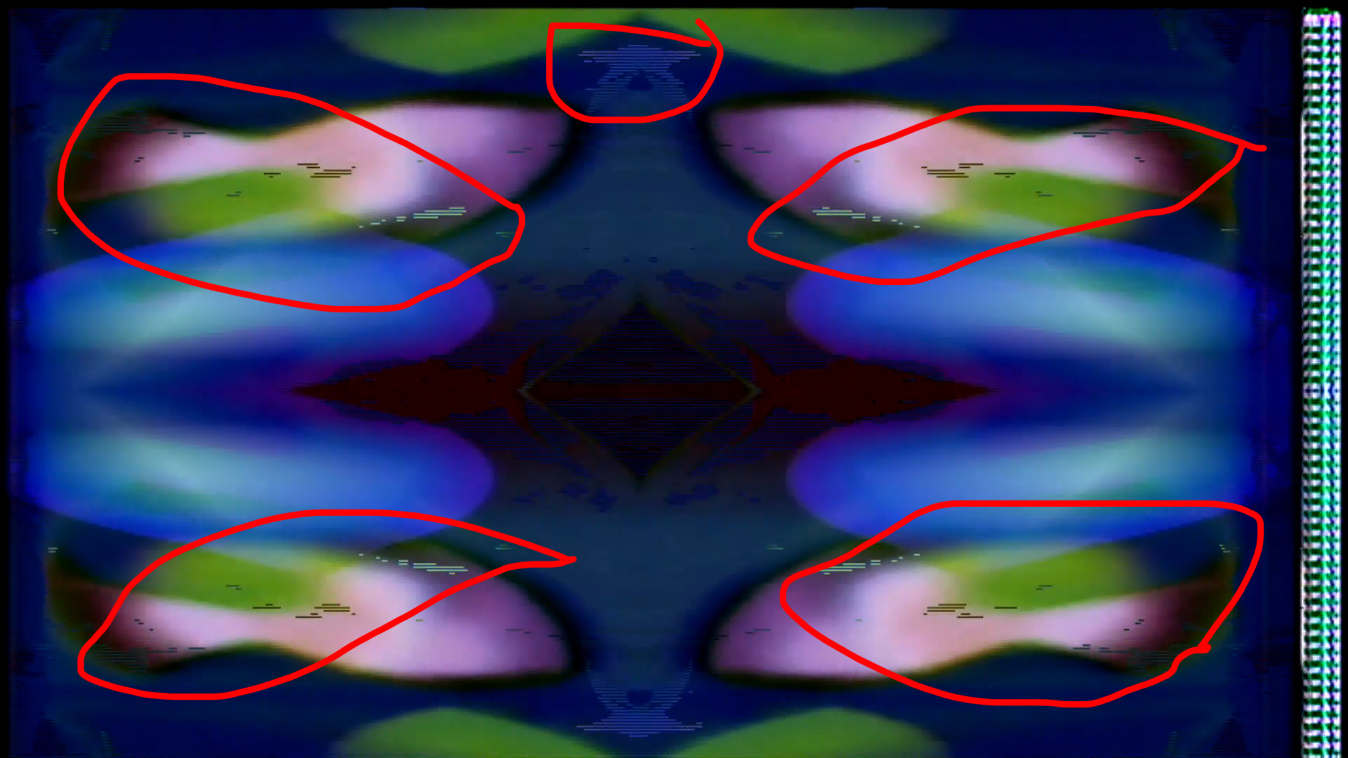

I ended up getting a BenQ projector with a composite input for doing visuals in public places and a BMD Analog -> SDI box for capturing to my new BMD Web Presenter or (in transit) BMD ATEM Studio HD.
The signal is really jumpy on the analog to SDI, however. I haven’t updated the firmware yet and am hoping that’s the issue. Capture looks gorgeous @ 720p otherwise. :heart_eyes:

I’ve been using the Blackmagic Mini Converters - Blackmagic Design Mini Converter Analog to SDI and Blackmagic Design Mini Converter UpDownCross HD for a couple months now with no more interlacing issues. They’re also way cheaper than the Roland scan converter I was using before, which is awesome! Definitely would recommend them. Thanks for the advice!
