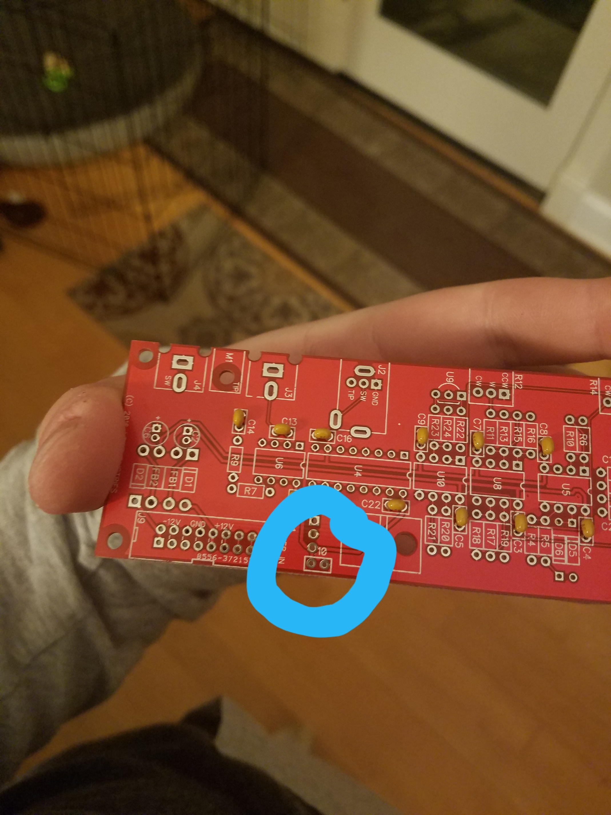

First off, in the bill of materials, it lists off a capacitor as C10, but I cannot find it anywhere on the board itself. I see two contacts simply marked “10”, but I would like to make sure before I put solder to board.

Can you show me a quick picture of the confusing contacts for C10?
sorry for taking so long. Here it is!

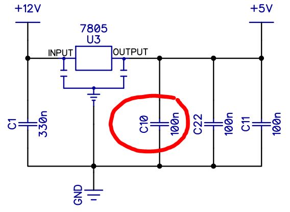

You found it, that’s C10. It connects to PIN 3 of the 7805 regulator.
