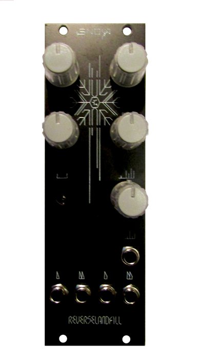

Yeah, two different animals. WOTA is hard to find and SNOW is available for purchase. SNOW has two different noise channels, each with a high-pass out, as well as a comparator output. WOTA integrates well with the H and V processing chains of the Expedition series. It features dual switchable high/low pass filters and also has semi-random lfo that affects the intensity of the noise.
Another noise option is to blend the outputs of a SSF Quantum Rainbow, with a Brownshoesonly video mix. You need to scale the 0-5v signals into 0-1v however you can attain a WOTA-like blend of high-pass (blue/purple) and low-pass (red/pink) noise.
I like all three options. I love the starfields that I can get from the comparator output of SNOW. The only knock on the WOTA is that you can only use it for NTSC/PAL signals, whereas the other two options will integrate with Gen3 HD workflows. I know @Fox is working on a filter module. Once that is released, I’m sure it will pair well with SNOW.

The SNOW does not have sync and has output jacks only.
The WOTA can be modulated with CV, it is a different module altogether.
If you mix two SNOW outputs (one from each channel, with a mixer that has both normal and inverted inputs such as the CMIX) , you get nice layered textures.

Different builds of Reverse Landfill Snow can look different depending on the pairs of transistors that are used in it.
I do love mine and it sounds great as an audio noise module.
