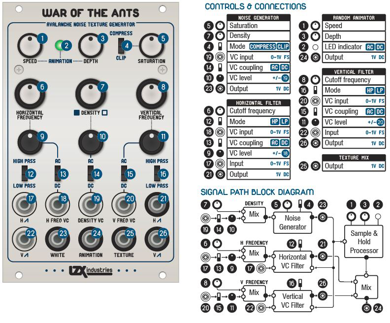

  • Make sure to connect to a sync source to activate the module’s Animation and Speed controls.
  • Patch the horizontal and vertical components of your shape,
    whatever their source, into the horizontal and vertical filter VC
    inputs on War of the Ants. Patch the H and V mix, or a variation of
    it, into the Density VC input. Adjust the VC level controls for the
    desired look.
  • Use a mixer module such as Color Chords, Passage, or Bridge,
    to combine the Texture output with the H and V mixed shape.

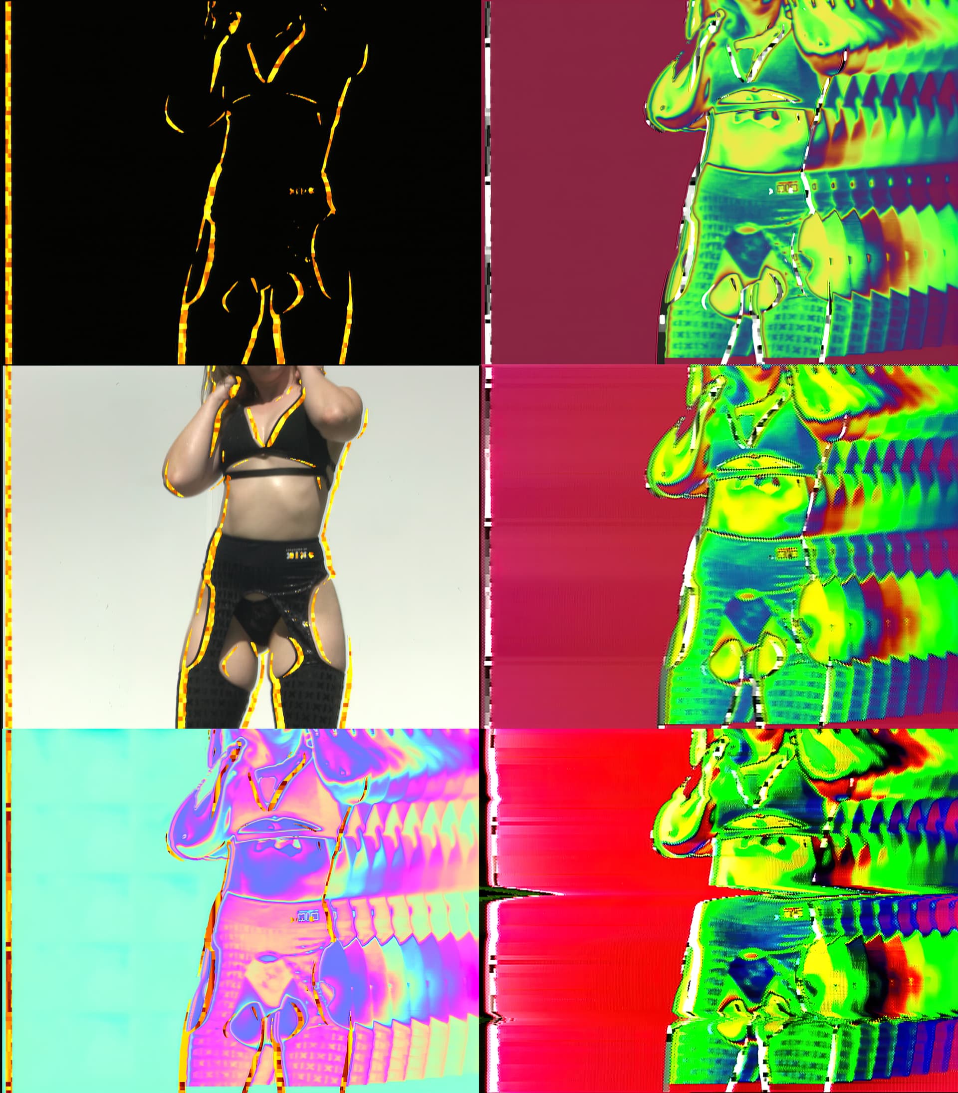

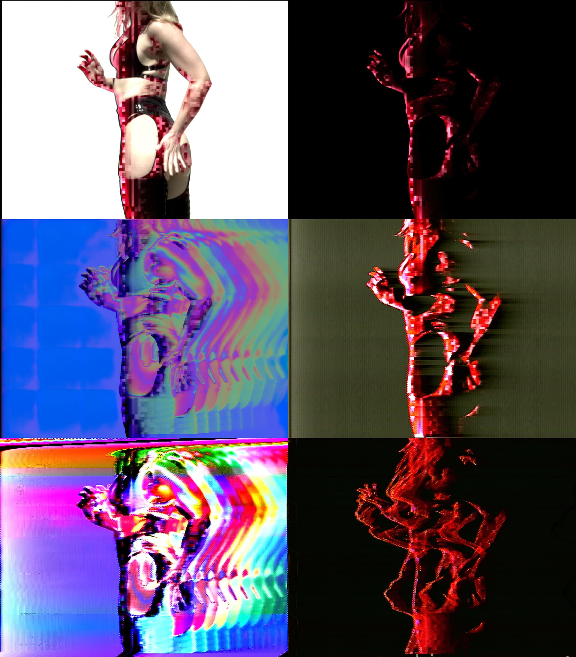

The Patch
  • External video source RGB is patched straight to Visual Cortex A channel (the Background.) And the video source LUMA is patched directly to Curtain input.
  • Curtain is either patched to the Key input or the Fade VC input or the Colorize input on Visual Cortex. Three different worlds to explore there. Patch it thru a free channel of a Passage to gain some extra fine tuning capabilities.
  • War of the Ants is patched to Visual Cortex B channel (the Foreground.)
  • After setting up the basic patch, dial in the edge settings until you see the WotA texture appearing inside the edges of your source footage. Play with Visual Cortex RGB controls and blending mode settings until you like it.
  • Now start focusing on the texture synthesis – modulate War of the Ants with Prismatic Ray and Pendulum, or use utility mixing to combine all the outputs in interesting ways.
