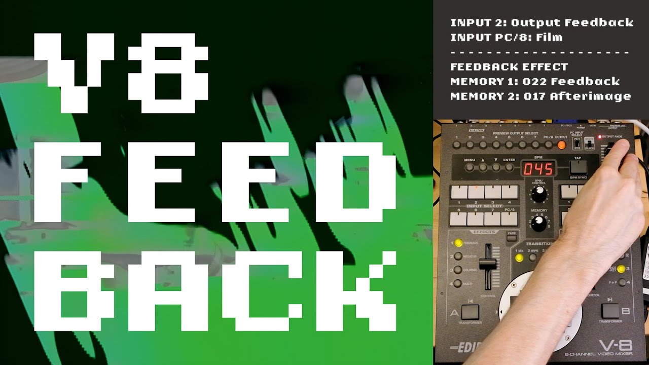

Was bored last night, so made a video exploring some more possibilities with the V8 feedback (and “afterimage” frame buffer) effects. It’s just one long roll, and thus a bit of a slog. But some nice moments in there, I think:

No problem. Easy enough to play around for a few minutes and edit together a couple captures.
Did a little more last night, since I still had my camera pointed at thee olde V8. The effects have a slightly different feel when used on the repeating, softer patterns of these LZX patches than with film footage:
Probably should’ve tried a hard-edged, Castle-y patch as well,… But maybe that’s part 3? (EDIT: Yeah, I did that too. Watch it here.)
EDIT 2: Aaaaand going even more overboard also made a part 4, wherein I add more effects to show a broader range of possibilities:
