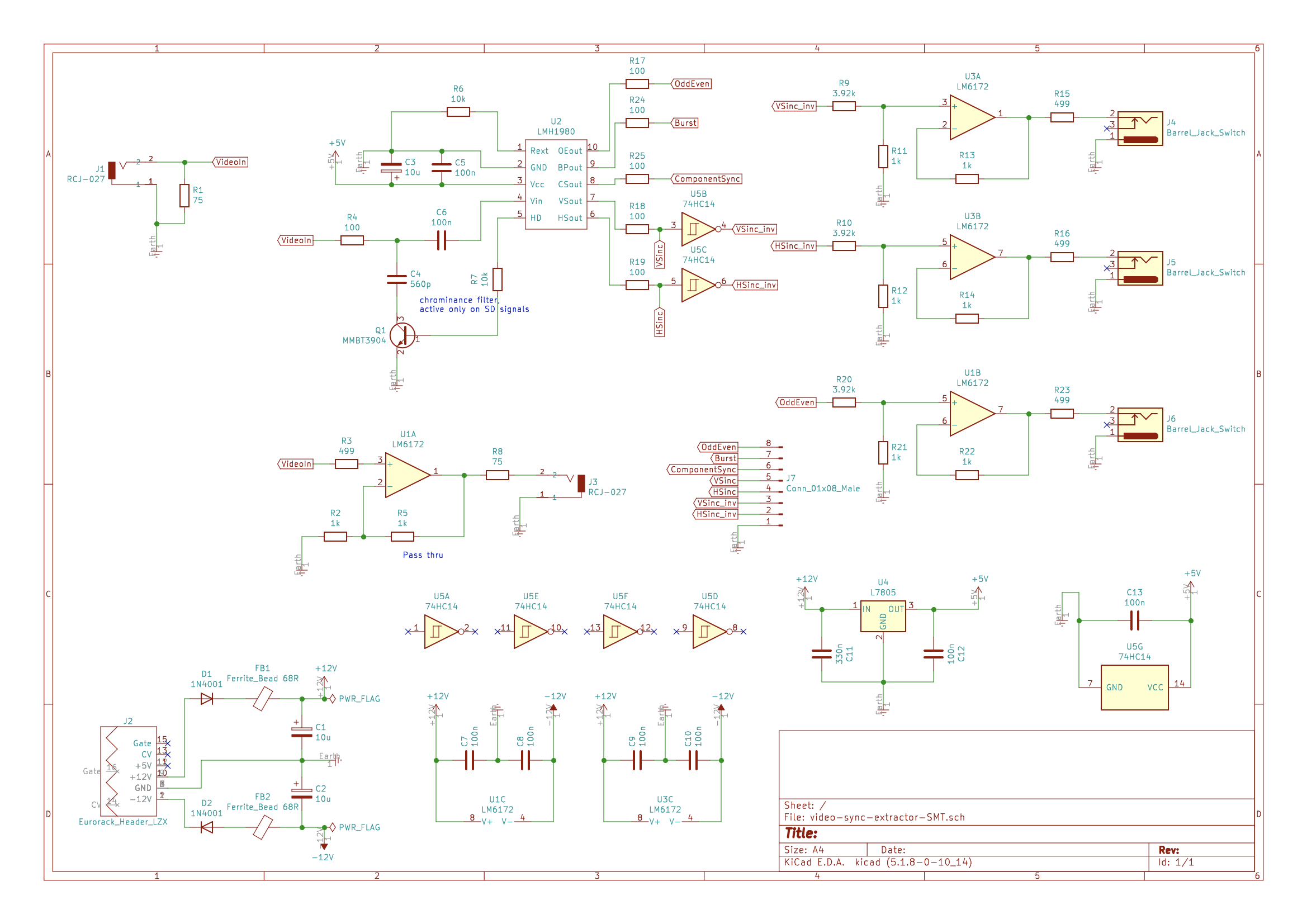

Lars thanks for the great support, I’d love to put a led on the HD detector but I guess I’d need a new op-amp to buffer the signal and avod issues on chrominance filter ![]()

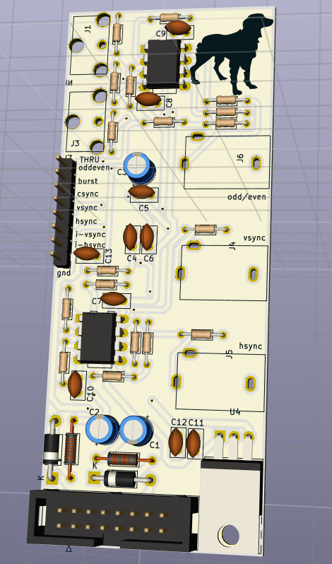

BTW I did my best to create a breakout for the various sync signals, here it is! They are all unbuffered but I guess they are enough as expander/diy option.
