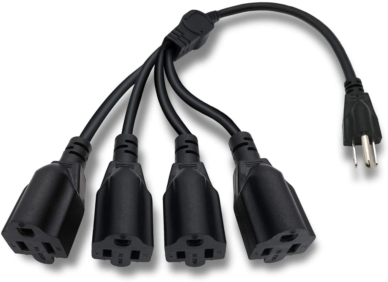

I have a power conditioner (StarTech) in my rack case, with a bunch of these on the rear outputs – works great for getting a ton of wall-warts organized!
