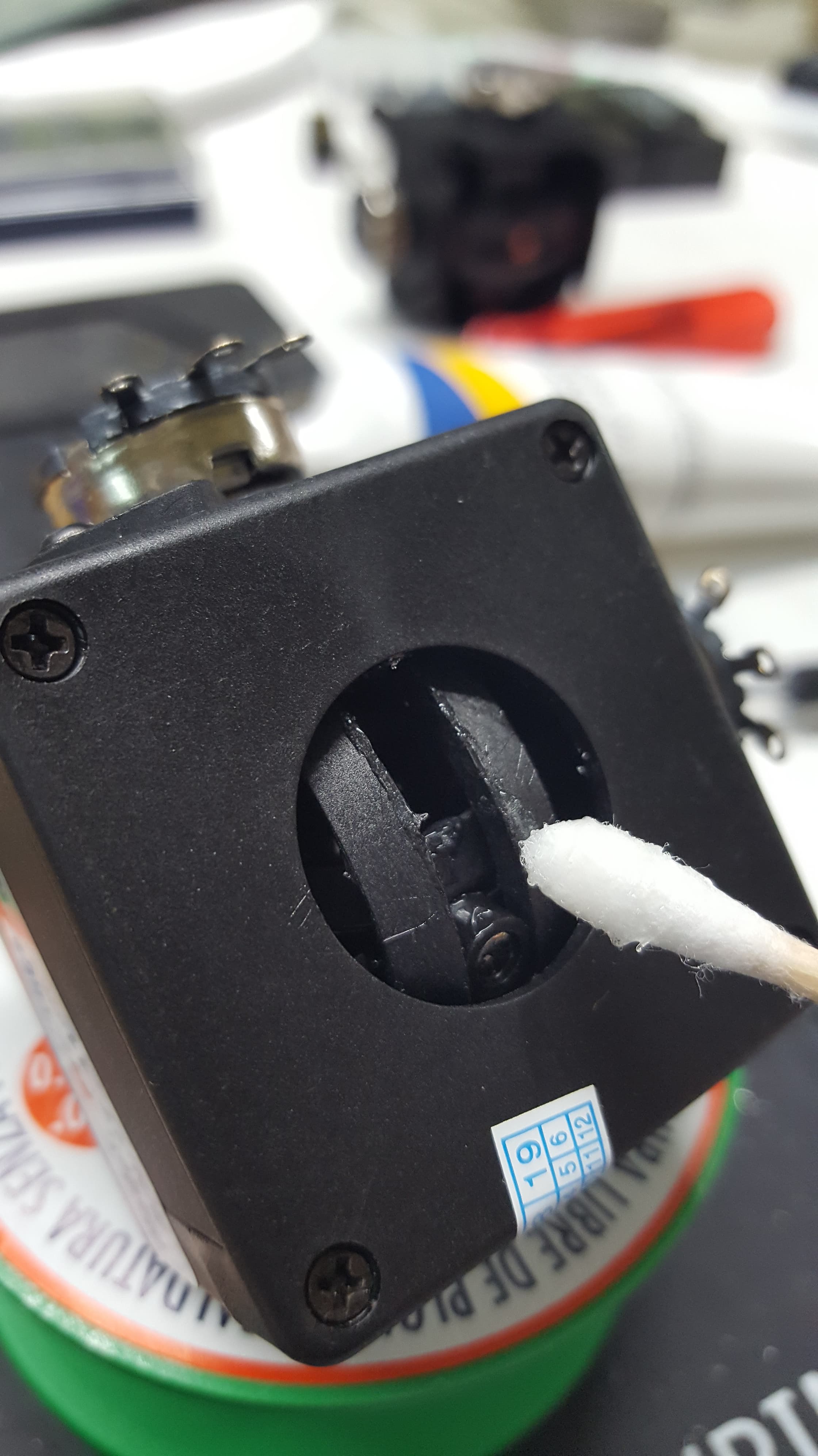

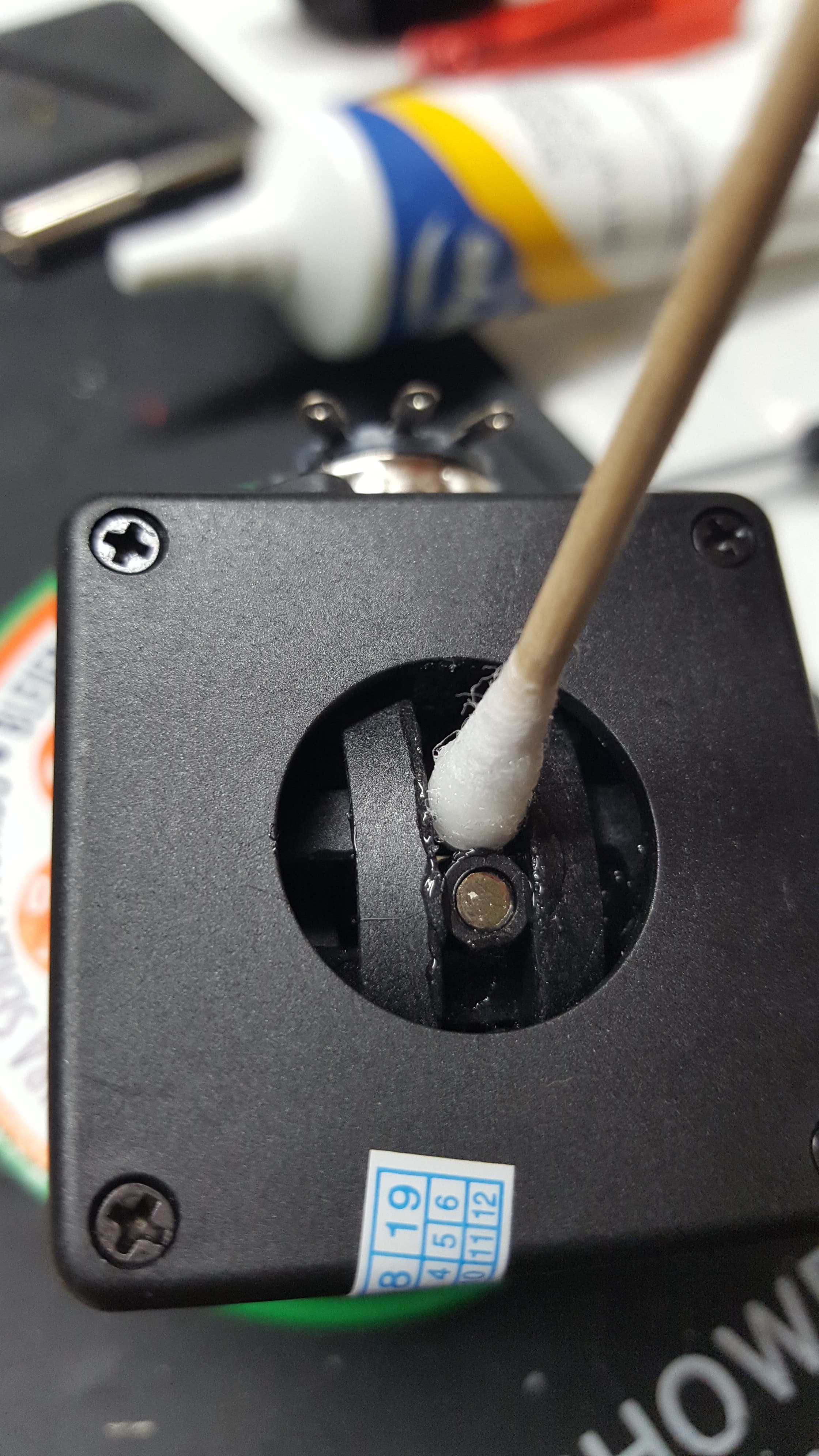

Hi,
I used Park Tool Polylube 1000. Also called PPL-1.
To do so I removed the module, removed the back plate of the joystick area, and adjust the joystick so that I could see ball as clear as possible. Then I applied a little bit and exercised that joystick until the grease was distributed around the surface. Then I did it a few more times.
I don’t recommend putting a lot on all at once.
Definitely improved the fluidity of the movement and it stays in place much better.

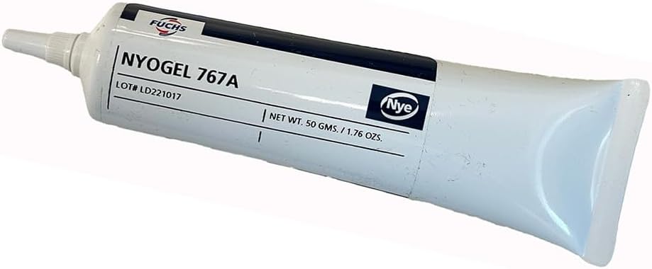

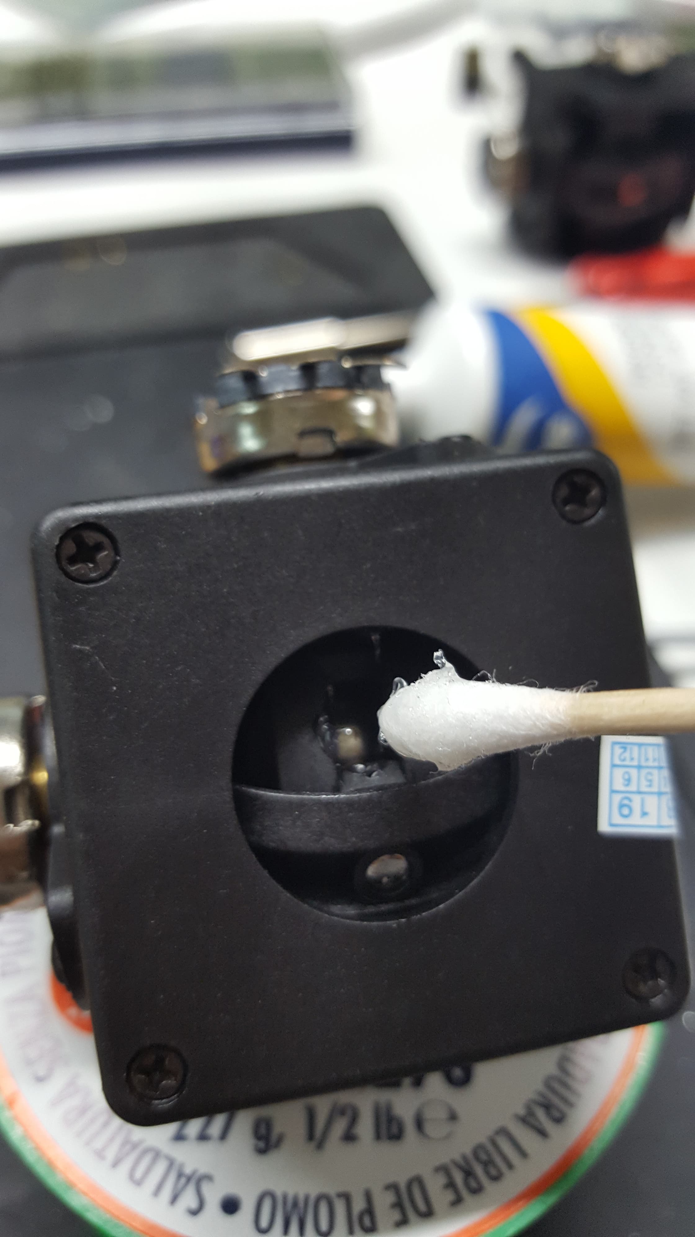

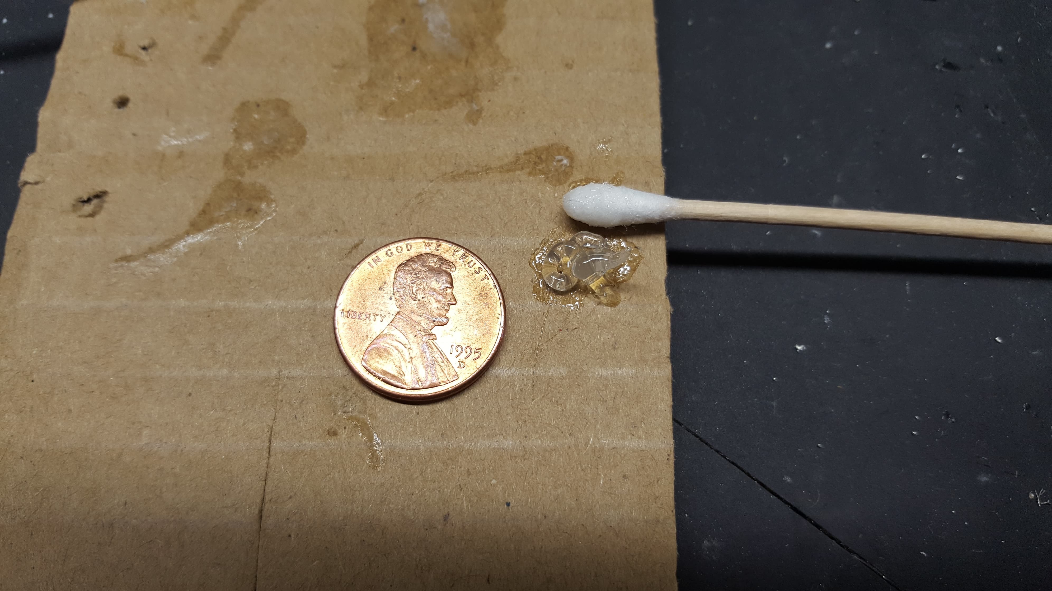

Alright folks the solution I’m suggesting here is using Nyogel 767a damping grease.
A small swath along the inside of both tracks of the joystick has improved tactile performance dramatically. Smooth travel and solid hold.
https://www.oveready.com/flashlight/nyogel-767aa-damping-grease-10g-tube/
